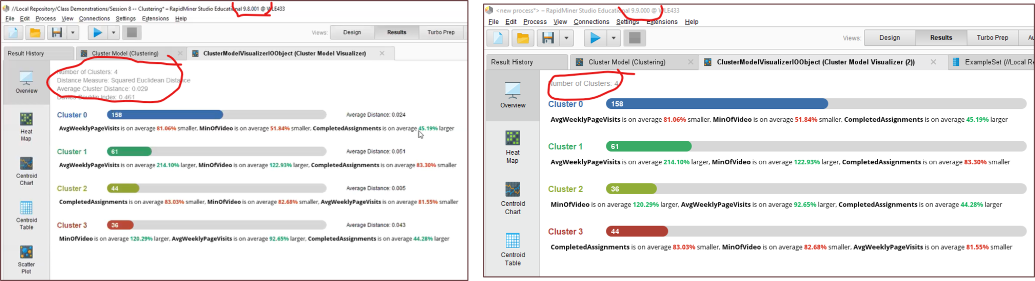

Hello! I'm teaching intro to ML and it seems like something in RM changed between quarters.
In 9.8.001 the Average Cluster Distance was output to the results window, but doesn't seem to be the case in 9.9.000.
This was with a simple data set (3 integer features), z-transformation normalization, k-means clustering (k=4), and the cluster model visualizer. Other than k=4, the default parameters were used.
I know I can use the Cluster Distance Performance operator, but it was *so* convenient to get that info from the the model visualizer.
Here's my XML, in case you can point out something I'm missing!

Hi @Unperterbed,
To obtain the average centroid distance, just connect the per output port in your Performance Operator to a res port.

Hey @ceaperez,
Yes, I'm aware of this. My question was whether average cluster distance can still be output by the cluster model visualizer (ie, am I just missing a setting somewhere?) or whether it has been intentionally removed (in which case, please bring it back!)
From my perspective teaching intro to ML with RapidMiner, every additional step or operator means another 3-5 students get lost at that point. And, in my opinion, cluster distance performance is a particularly confusing operator because of its inconsistent node labels and the need to criss-cross the connectors from the k-means operator.
Perhaps it'd be better for me to make a feature request, but I wanted to post here here just in case I'm overlooking something obvious.
