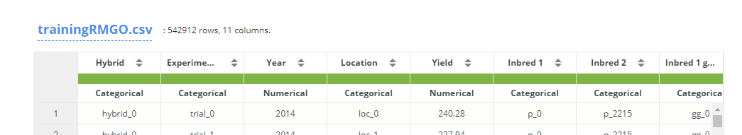

So, I have a file of size <50MB, 11 attributes and 542 919 rows. No missing data in the dataset - not a single one.

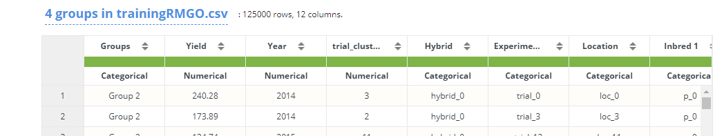

I 've run a classification on it, but unfortunately, it got truncated down to 120 000 rows.

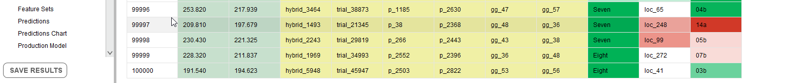

When I execute the same Modeling with AutoModel in Studio (I have Free Educational License with would come with a month of Enterprise Studio) I get even more truncated results - It all stops at 100 000 rows.
Even worse - there is not a single missing point in the dataset, but there are missing in the prediction.
