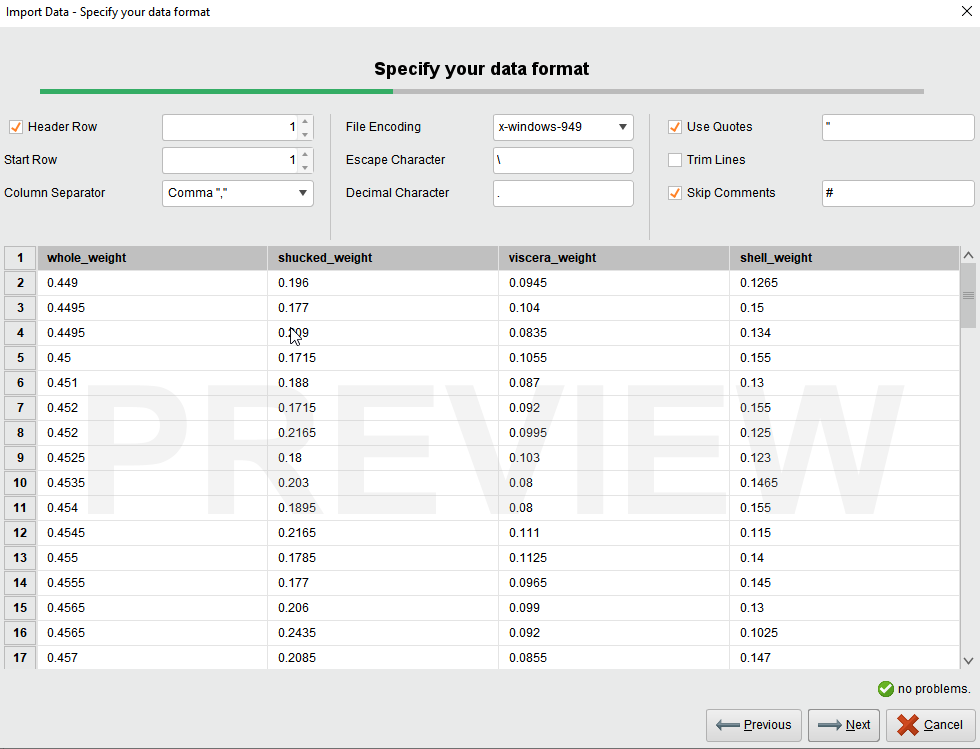

Hi, all.
I am in trouble using the Read CSV operator.

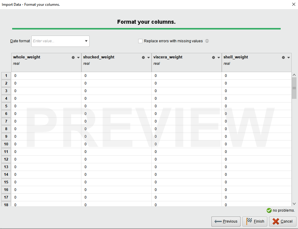

I opened the file, clicked the next button, and saw every value is 0 in the page named format your columns.
I have no idea why some files are shown like that
I attached the screenshots below. Thank you

    OK, I think I understood :
    Please go to Settings -> Preferences
    and go to Number Format
    and set "fraction digits of numbers" to 3 (I think that in your case it is currently set to 0)
    With this settings, your dataset is displaying as expected on my computer...
    Hope this helps,
    Regards,
    Lionel
  • ykim7
    ykim7 New Altair Community Member
    Thank you so much, Lionel.
    I solve the problem with your advice and appreciate it.
