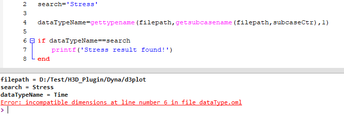

Using the attached script, I request the data type list present in the d3plot File (also attached:Bumper.7z), and I store the first element in a variable.
I would like to comapre it with an input string.
Apparently the dimensions are different:
Does anyone have an idea what I am doing wrong?
I am not sure what type is being returned by the command 'gettypename'.
I presumed it should be a string, which I could compare with other strings.
Best Regards,
Deb

    Hi Debdatta,
    the if statement 'dataTypeName==search' compares number of characters in both variables.  That's the reason why the error raised.
    Instead use 'strcmpi' which compares the characters itself in variables
    if strcmpi(dataTypeName,search) == 1
    % 1 == logical yes if both variables are identical
        printf('Stress result found!')
    end
