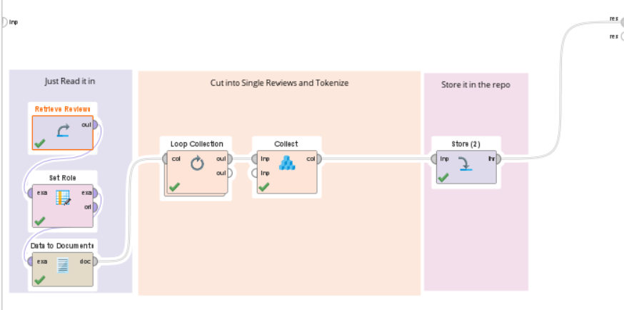

I was using TFIDF  in my process, now I want to use wrod2vec instead of that. I have a CSV file that contains 3 columns
  • Name
  • Review
  • Sentiment
for reading my data and prepare it for word2vec I did this:

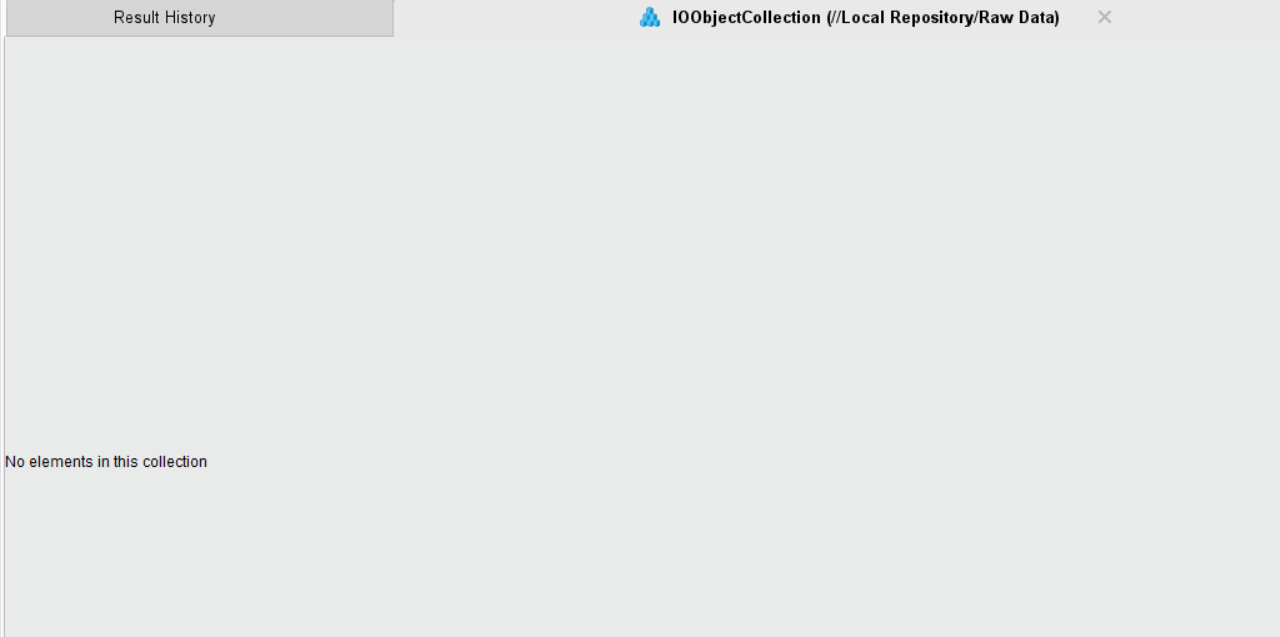

but when I open the stored file, it's an empty file:
I can't find the problem, I really appreciate if any help

    Ensure your field to analyze is of text format, use nominal to text in order to do so if it's not the case.
