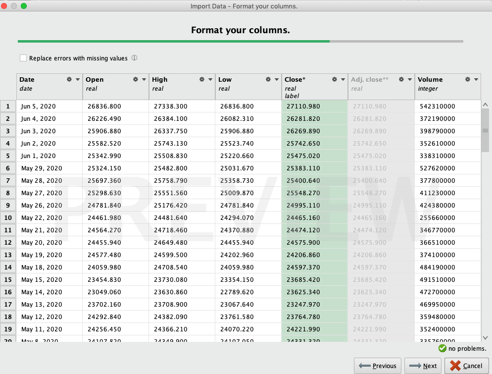

2) I had to type "Close" in manually in the attribute drop down because the drop down is always blank nowadays whatever Excel file I use (and by that Excel files that I know have worked in the past with RM) and whether I use Import Wizard -- which has been not working as expected because I now get issues with a column called adj.close:
3) What's even more obvious is that I don't even have that adj close column anymore because I already deleted it from my Excel file (I've done everything to get round all these constant RM errors/warning messages). RM clearly has a Excel file caching problem:

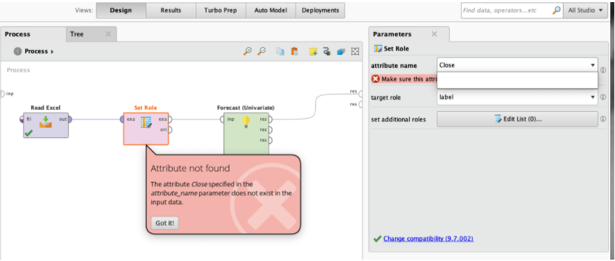

When I manually add the Close:
I get this warning saying the FTSE file does not exist in repository even though I can see it?:
Can you please explain how to permanently fix these time consuming problems using RM? Again, respectfully, please note I had none of these problems with RM when I first started using it, files loaded and attribute drops down self populated... and I was always constantly changing my Excel file without any issues too.
Lastly, in my previous post I asked why is the FTSE file referring to an error with row 102. There is no row 102 in my Excel file?
Thanks very much,0 -

I got the FTSE one sheet file to load but the Set Role operator now has an error saying the attribute close is not being found when using the import wizard even though I set close as my label with the import wizard using Read Excel (I never had any of these problems when I first started using RM with the single complex 5000 row Dow sheet Excel file).
I have been trying to resolve this issues for literally weeks now -- I quit RM and rebooted.
Now I get this warning (I used a breakpoint) :
I then decided to use an old Read Excel / Store process that I already have that works and set it to the FTSE file (instead of the Dow file that works fine). The FTSE data reads okay without bringing in the ghost adj close column. Why is that? What's wrong with the Read Excel operator I have in all the screenshots above?
As for Set Roll it doesn't populate with Open/High/Low/Close/Volume columns?
It doesn't work although I've manually written in "Close" either?

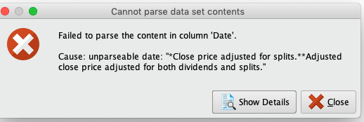

I normally pride myself on my attention to detail but you're not going to believe this Martin, @mschmitz, the Set Role was not able to find the Close attribute with the FTSE data because of an asterisk... As in: Excel Column E = Close*. Instead of the correct: Excel Column E = Close. Please see the 2nd image I posted at the top of this thread.
I removed the *. Now it loads fine just like my Dow data did.
What's odd is when I went back to re-download the FTSE data just now (same link to Yahoo Finance that I used before from google, as it's purple highlighted in Chrome), no such asterisk appears with the Close in my new Excel download... What's even stranger when I ran the Forecast I was getting predicted close values from the 18th Sept. onwards. that's because I've just noticed that the 4 months worth of data in my FTSE file I downloaded last week has prices going to the 18th September 2020!? Prices that don't even exist yet... Yahoo isn't even currently showing a chart for the FTSE either...

So.. Does this mean our Read operator did not handle '*' signs correctly?
0 -
Yes, but where and why there was an asterisk in Excel in the first place when I've only ever seen if assigned to the adjusted close column I have no idea!0
