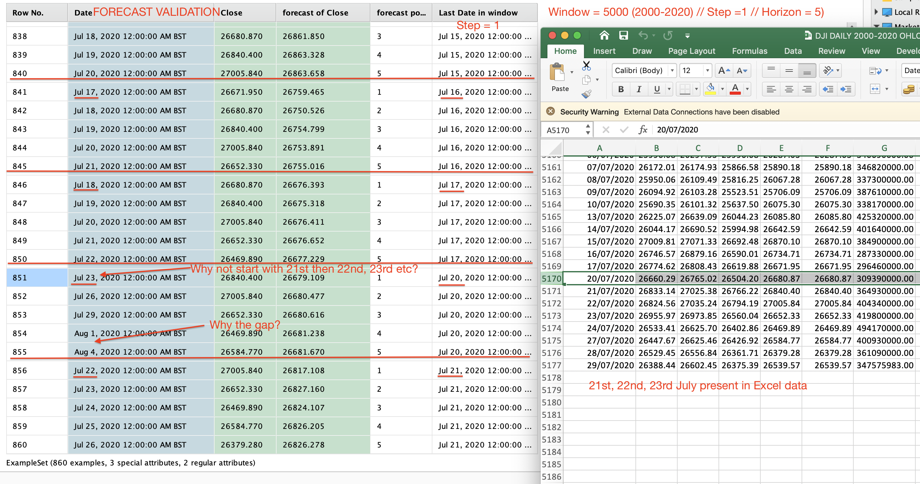

My Dow Jones data and indicators cover the years 2000 to July 29th 2020. I had a Forecast Validation set up with a Window Size = 250, Step = 20 days and Horizon = 5.
I've noticed in "Forecast Validation" an odd thing with the Daily predictions. They work throughout the data but when you get to the bottom this no longer the case with gaps between the days?
Pls see following images.
Scrolling down a little further to the very bottom and the prediction now appears to be every 3 or 4 days? It does this whether the Step is 1, 5 or 20.
And again with a different Step = 1:
I'm not sure why it's skipping prediction forecast days and I don't recall changing anything as it used to work fine and give consecutive prediction days: (This last image from last week)
Any help gratefully appreciated as I can't figure out why it's missing days now!?

This is due to the fact that your initial data is not equidistant. You have daily data, but you also have gaps (probably from the weekends) in your data. ARIMA (or any forecast model in general) uses the difference between the last two index values, to create the index values for the predicted values (You need equidistant data for ARIMA in general). When by chance the gap is the last entry in the training window (as it is for example for the 2020-07-20) you have 3 days inbetween the forecasted values.
What you maybe can do is using Equalize Time Stamps to make all your input data equidistant. Note that this basically interpolates the data for the weekend days and the trained ARIMA is also fitted to this interpolated data.

Thanks for getting back to me Fabian @tftemme, that makes sense.
Consecutive Days:

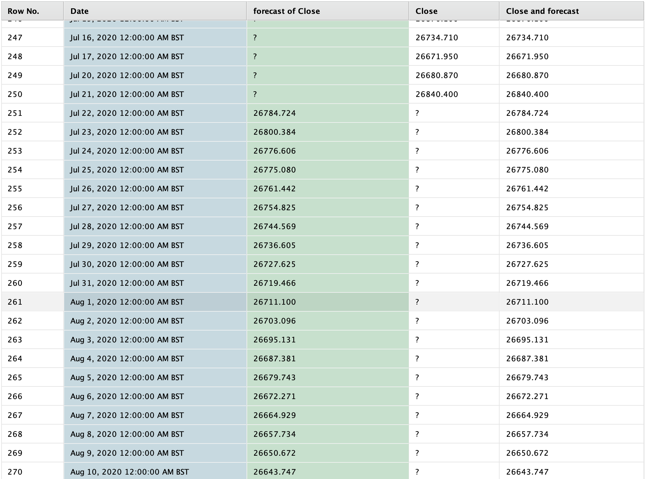

What I can't figure out is what settings of window size and step size I used (the step was a 20 day horizon) that gave me that August consecutive days predictions above (and I have tried like a hundred different combinations!) because it's the same data and I haven't updated it?
"Future" Predictions:
I was using a 250/5/20 which gave me results up to 28th August (albeit with 3 day gaps!) but when I tried a step size of 6, the Apply Forecast only predicted up to July 14th and not into the future month of August, why is that happening with just a one day increment in step size?
I even tried a step size of 1 day (250/1/5) and it still only forecast predictions to July 27th?
I don't understand if the Excel's last datapoint is the 29th July, why it won't forecast from the 29th July, forward? Same with 250/1/20, that only predicts to July 20th? Why not from the 29th July in to August? (I've made sure both Forecast Validation and Apply Forecast have the same horizons).
I did try inserting break points but could not infer anything useful. I will look again.
The Horizon I had was definitely 20 (from my August daily predictions screenshot) when I got that consecutive daily prediction for Aug 1st, 2nd, 3rd etc last week and there are only Window and Step sizes to play with (and I've tried but can't get any future predictions now). Pls see image:
All other settings were left the same...
All I can get now are flat (green line) past predictions in July 2020 (data set ends 29th July) and not for August as I was originally getting. Pls see image:
From earlier trials of window size going into August (My data ends 29th July) with Wd 5000/Step 10/Horizon 20:
