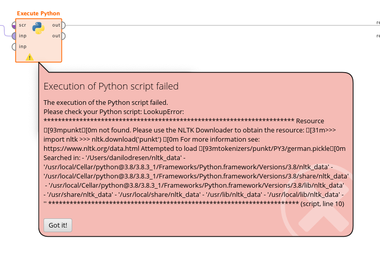

Hey there,
I'm trying to run a python script to make use of pythons spelling correction feature via textblob. Everytime I get this error message
it looks to me that rapidminer searches the wrong path for the needed files. How do I change those?  Or is anything else the problem? Because I double checked if I installed the necessary files and like I thought everything needed is provided

    User: "jacobcybulski"
    New Altair Community Member
    Accepted Answer
