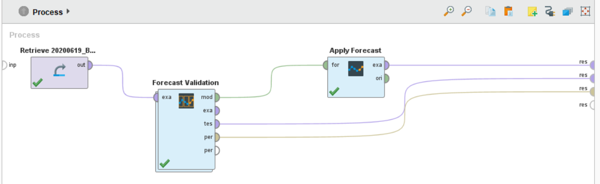

I am a beginner with RapidMiner and have run into the following problem. I am using the Holt-Winters model to make predictions from a time series. I started with applying the model to my data. Then I added a forecast validation by creating this process:

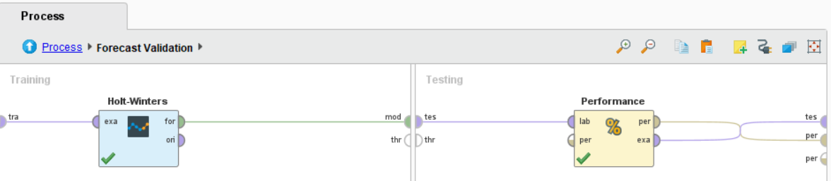

Inside the Forecast Validation it looks like this:
So far so good. The process works, I get results and a validation of the results.

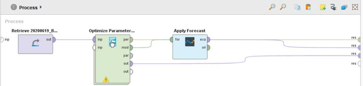

At this point I wanted to add an optimizer, which automatically determines the best parameters for the Holt-Winters model. This is where my struggle starts. I adapted my process by adding the function "Optimize parameters":

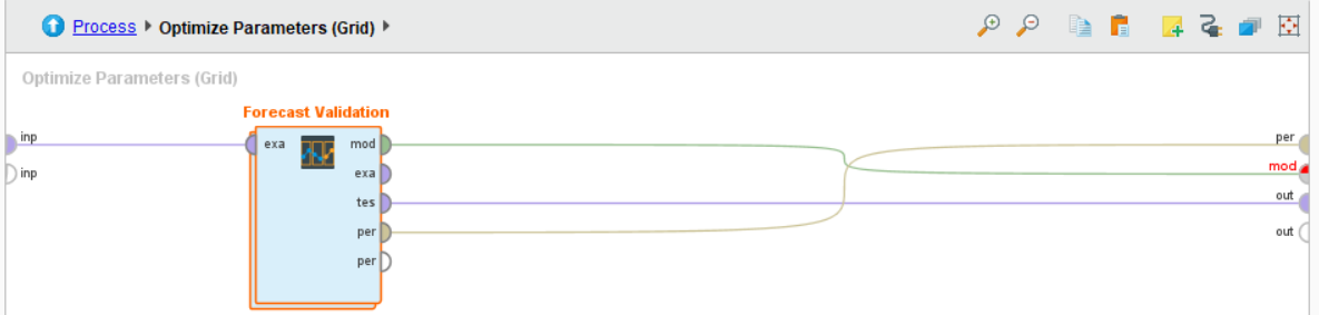

Then I inserted the "Forecast Validation" into the "Optimize parameters" function:

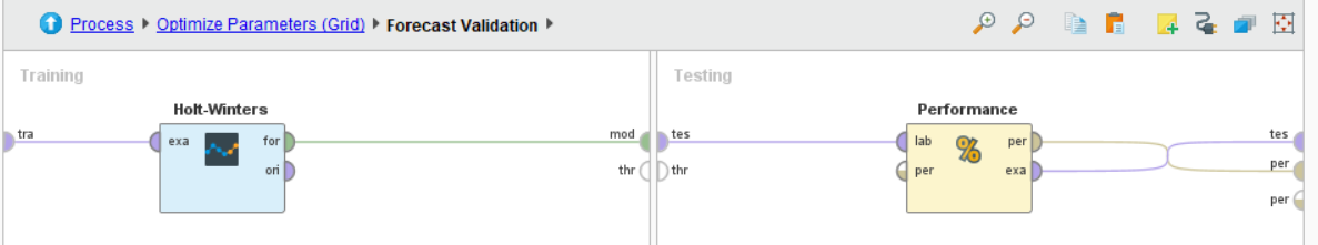

Inside the "Forecast Validation" it looks like this:

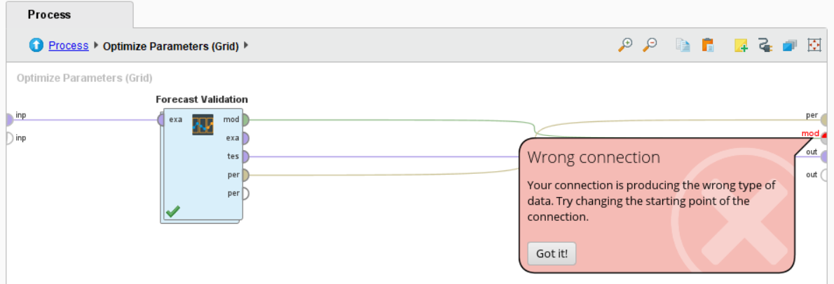

Now when I run the process, I get the following error message":
I already tried rearranging the functions in various ways but I didn't manage to solve the error. Please find attached the RapidMiner process. I really appreciate any help!

Hi @Big_Burger ,
please take a look at my attached process. I've adopted your solution with an example data set. The trick is to connect the time series model to the generic "out" port inside the Optimize Grid operator and also get it from the same output port in the main process "outside" the operator (you can see, that this output port then also is green, indicating a model is connected to it).
I hope this solves your problem.
Best regards,
David
David
