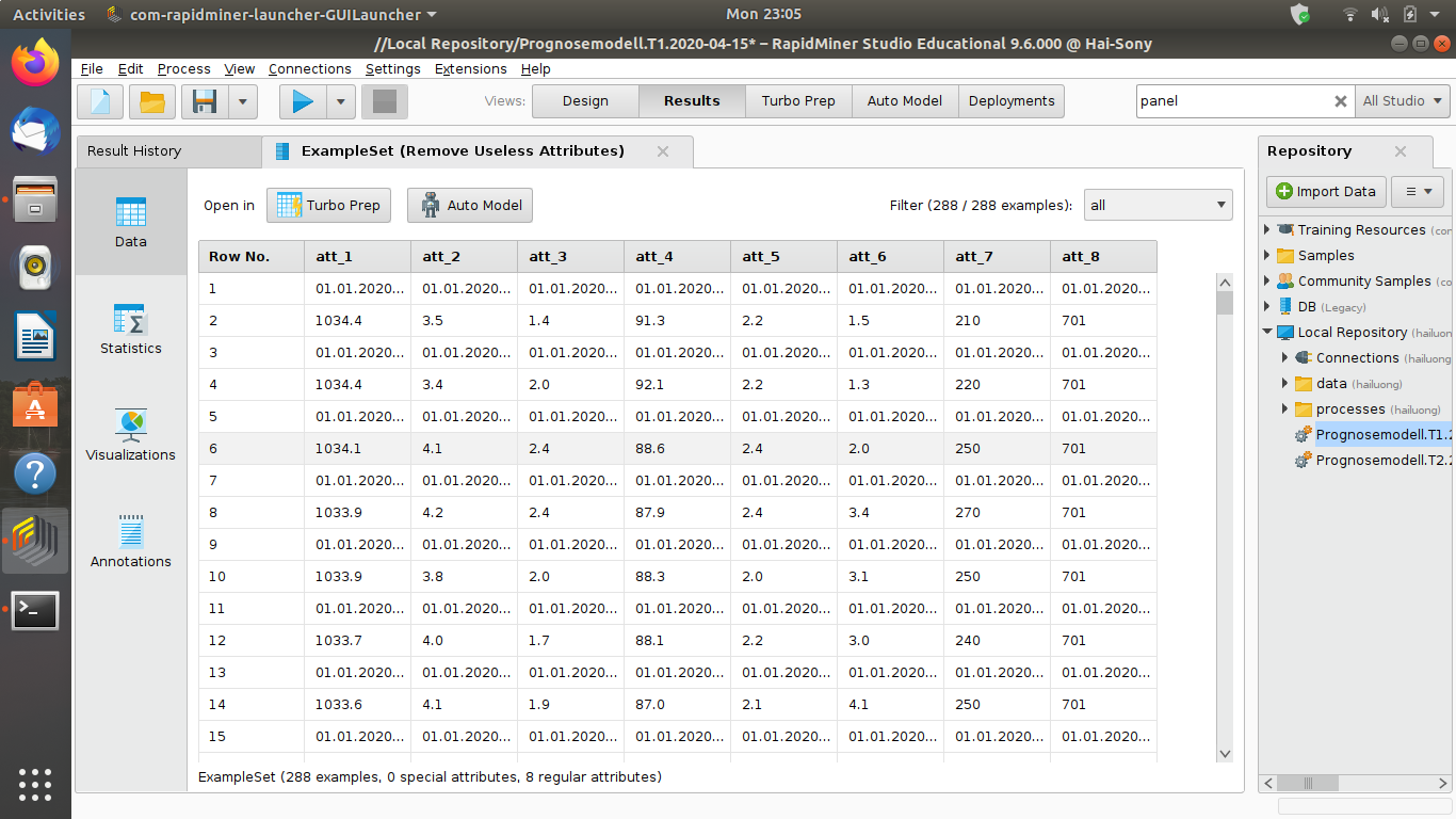

Hi guys,
i am a new member of the Rapidminer community and would like know, how can i just remove or delete automatically several attributes or rows, which contain certain  kind values? For my apllication i dont need the time stamp and would like to delete them from my example set. Thank you :)

    Hi @sharki,
    That was interesting to solve !
    The idea here is to find  and replace the timestamp values by the caracter "?" using a regex to "capture" the timestamp values for each attribute, so I'm using Generate Attributes operator with the following expression :
    if(finds(eval(concat("att_",%{iteration})),"(0[1-9]|[1-2][0-9]|3[0-1]).(0[1-9]|1[0-2]).[0-9]{4} (2[0-3]|[01][0-9]):[0-5][0-9]"),"?",eval(concat("att_",%{iteration})))
    then I loop over the attributes to remove the example(s) which contains the caracter "?"...
    Note that the attributes names have to be "att_1", "att_2", "att_3" etc. ... but according to the last screenshot of your first post it is already the case.
    You have just to put the process in attached file at the end of your own process.
