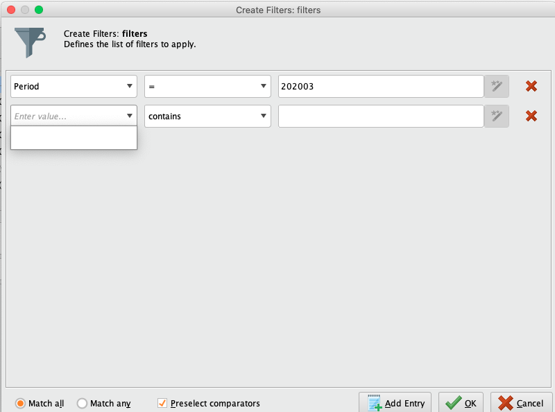

Is it normal that no attributes populate the drop down box on operators like filter?
Columbia
Columbia New Altair Community Member
edited November 2024 in Community Q&A
On operators where I can work on attributes, I was expecting the pull-down would give me a list of attributes (columns) but the box is empty and I have to type them in one by one.  That does not seem normal.  Notice there is  down arrow but the selection is empty so I have been typing in the column name which is tedious.

    Hello @Columbia
    Can you check if the option "Validate Automatically" is checked? You can see this in Process --> Validate Automatically in the top menu bar.

  • Columbia
    Wow ... excellent ... worked like a charm.
