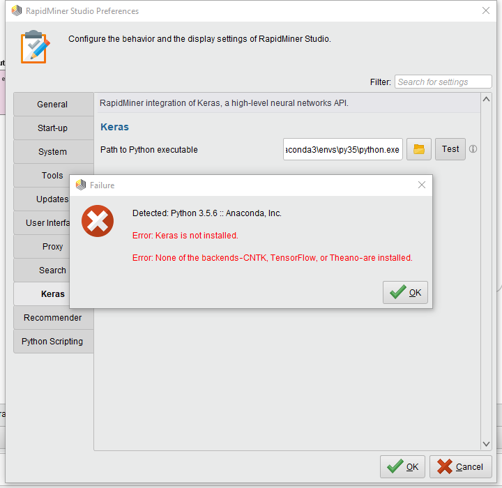

Hi everyone,
when i clicked on the test under the preference setting, an error occurred showing that keras is not being installed (fig1). But, i have checked that my keras is currently installed (fig2). Is it due to compatibility of python? Any assistance would be great appreciated. Thanks.

@varunm1 It works! thanks alot. May i know what what version of tensorflow are you using? are you using conda install tensorflow as well? thanks

Hello @vincent123
I installed Keras 2.2.3 using conda install keras in python 3.5. It is working fine.
Try installing that version.
Note: The keras extension in rapidminer i old and not supported as they are working on deep learning extension based on DL4J
