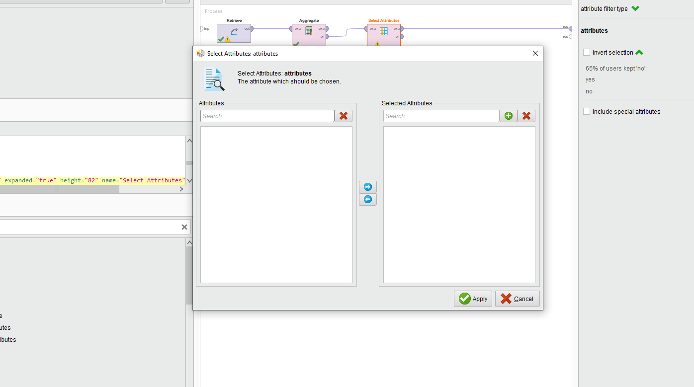

Am I missing something with the Aggregrate operator?
I am trying a simple aggregrate function to Count, sort by averages of two columns. Seems like a simple exercise. Apologies, I come from Alteryx and the option to change from integer to float or to string was integrated in their tool.
I Love Rapidminer but this seems to be an east function I am unable to get. Can anybody please help?
Why am I not seeing any atributes/column headers?

Hi @lionelderkrikor.. I would definitely try that.. (wish I could remote to my computer rn). It seems like to be a basic operator requirement to have these there. There were when I was trying the model before. Probably just a bug. However, I am trying to get averages and grouped by columns. These averages are whole integers and not float. Again.. this is a basic operator need.. can you please upload the best, most commented flow for this job? (I am a noob at Rapidminer. I love to solve problems but this is using up a lot of time).
Much appreciated
Much appreciated

I have difficulties to understand what you get and what you want to obtain ...
Can you give an example ?
If you don't see the attributes names, you can manually enter the relevant attributes names in the "Selected Attributes" user box and click on the "+".
