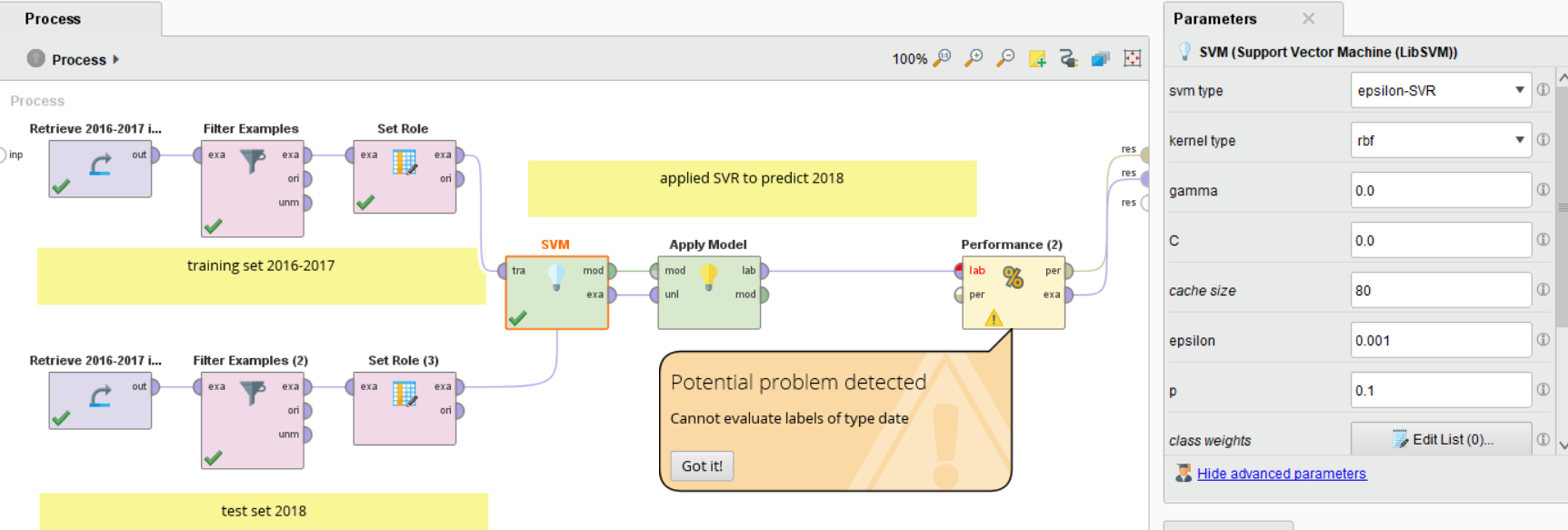

Hi everyone,
I want to apply support vector regression with sales data for training from 2016-2017 and for testing from 2018 (label date). My aim is to see the forecast value for the next 4 periods. But operator "apply forecast" doesn't work and operator "Performance (Regression)" doesn't evaluate labels of type date. For parameters choosen see screenshot below. If any data are missing, pls comment. What do I have to do??
Thx and cheers,
Sarah

In your process, I see "Datum" (I think date) is set as a label and one more "Aufzugstechnik" is also set as a label. A prediction model can only take one label attribute, In your case, it should be "Aufzugstechnik" I guess.

It says that you set a column with date data type as label column. Did you set that? Can you provide .rmp file (File --> Export Process) and dara for us to debug?1 -
Hello @varunm1thanks for your help! I specified the label and get now the prediction values. But how do I find "good" values for gamma, C, epsilon/nu and p? (nu-SVR or epsilon-SVR, I want to do regression). What is common practice? Doing CV? But how? See .rmp file in attachment. Currently the prediction doesn't include trend, seasonality; the predicted value is the same for the whole test interval.
