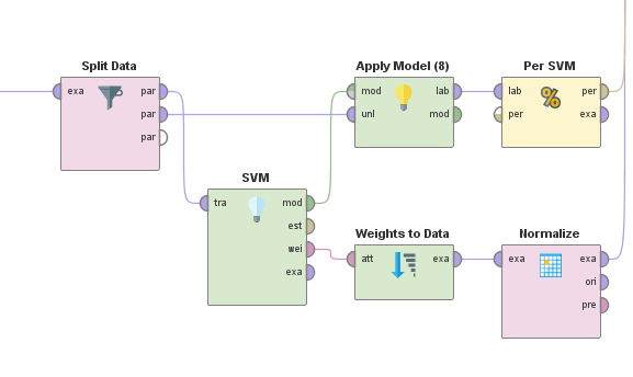

In this context I used the weighting function of the models. For example, the "SVM" operator or the "Linear Regression" operator offers the possibility to output the weights. The first question: Is it correct that this weighting by these operators is a so-called embedded approach? Furthermore, I would like to compare the results of the weighting by the models with the weighting by the filter methods. The problem is that I have not yet found a way to normalize the model-based weightings in the same way as with the filter methods. In the filter methods I can click on "normalize weight" in the parameter window. Unfortunately this is not the case with the models. I already tried to use the "Weights to data" operator and then the "normalize" operator (Screenshot 2) with method "range transformation" and min 0 and max 1, but I don't get the right results (Screenshot 3). The weights that are not normalized are approximately the same (see screenshot 1 and 3 on the right), only the normalized weights are not (see screenshot 1 and 3 on the left). For example, the attribute 0.07_ below has a weight of 0 while above it has a weight of 0.539?
Screenshot 2: Normalize the Weights of the model "SVM"
Screenshot 3: Weight Results from "Modell SVM" (left WITH normalization, right WITHOUT normalization) There are both 18 attributes only the presentation is slightly different, please do not be confused by the height of the two screenshots)

The normalize flag is just dividing by the maximum value, so that the max value is one. You can just do this after converting it to a table.
I am just too stupid to implement that
Maybe already too late. Generally I would do this after the "Weights to data" with the operator "Generate Attributes", but unfortunately I don't know which "Functions expressions" I have to enter, because I never really worked with "Regular Expressions" before. Could you just tell me what I need to put down there? I had thought about "Weight/max(Weight)", but unfortunately this does not give the desired result.

The trick is to put the maximum of the weights into a process variable (called macro). Afterwards you can just devide by this. See attached process.

You can also do this with loops, since Append can handle loop.
On your Normalization Issue:
A few additonal comments:
- Weight by SVM is effectifly a embedded method, since you use the support vectors of the SVM. It is not really a filter method.
- For all of these - Keep Select by Weights in your mind to select the attributes you want.
- For embedded methods: The selection of hyper-parameters may change the results significantly!
- Please also have a look at MRMR-FS from Feature Selection extension. It is a great algorithm.
Cheers,
Martin
Hi @MoWei ,
For the replace:
If you use pivot you need to specify a aggregation function. If there are two values in this cell you need to define whats done. By default it is average. So you create attributes like average(xxx)_yyy
I thought that this "average" may be confusing. So i decided to remove average( .. ). That's what the regex does.
For the normalization:
<?xml version="1.0" encoding="UTF-8"?><process version="9.3.001"><br> <context><br> <input/><br> <output/><br> <macros/><br> </context><br> <operator activated="true" class="process" compatibility="9.3.001" expanded="true" name="Process"><br> <parameter key="logverbosity" value="init"/><br> <parameter key="random_seed" value="2001"/><br> <parameter key="send_mail" value="never"/><br> <parameter key="notification_email" value=""/><br> <parameter key="process_duration_for_mail" value="30"/><br> <parameter key="encoding" value="SYSTEM"/><br> <process expanded="true"><br> <operator activated="true" class="retrieve" compatibility="9.3.001" expanded="true" height="68" name="Retrieve Sonar" width="90" x="246" y="289"><br> <parameter key="repository_entry" value="//Samples/data/Sonar"/><br> </operator><br> <operator activated="true" class="weight_by_correlation" compatibility="9.3.001" expanded="true" height="82" name="Weight by Correlation" width="90" x="514" y="289"><br> <parameter key="normalize_weights" value="false"/><br> <parameter key="sort_weights" value="true"/><br> <parameter key="sort_direction" value="ascending"/><br> <parameter key="squared_correlation" value="false"/><br> </operator><br> <operator activated="true" class="weights_to_data" compatibility="9.3.001" expanded="true" height="68" name="Weights to Data" width="90" x="648" y="289"/><br> <operator activated="true" class="extract_macro" compatibility="9.3.001" expanded="true" height="68" name="Extract Macro" width="90" x="782" y="289"><br> <parameter key="macro" value="maxWeight"/><br> <parameter key="macro_type" value="statistics"/><br> <parameter key="statistics" value="max"/><br> <parameter key="attribute_name" value="Weight"/><br> <list key="additional_macros"/><br> </operator><br> <operator activated="true" class="generate_attributes" compatibility="9.3.001" expanded="true" height="82" name="Generate Attributes" width="90" x="916" y="289"><br> <list key="function_descriptions"><br> <parameter key="Weight" value="Weight/eval(%{maxWeight})"/><br> </list><br> <parameter key="keep_all" value="true"/><br> </operator><br> <connect from_op="Retrieve Sonar" from_port="output" to_op="Weight by Correlation" to_port="example set"/><br> <connect from_op="Weight by Correlation" from_port="weights" to_op="Weights to Data" to_port="attribute weights"/><br> <connect from_op="Weights to Data" from_port="example set" to_op="Extract Macro" to_port="example set"/><br> <connect from_op="Extract Macro" from_port="example set" to_op="Generate Attributes" to_port="example set input"/><br> <connect from_op="Generate Attributes" from_port="example set output" to_port="result 1"/><br> <portSpacing port="source_input 1" spacing="0"/><br> <portSpacing port="sink_result 1" spacing="0"/><br> <portSpacing port="sink_result 2" spacing="0"/><br> </process><br> </operator><br></process><br><br>
For more infos on macros see: https://community.rapidminer.com/discussion/32966/how-to-use-macros
~Martin
