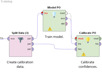

3. Can you explain further the function performed by the Rescale Confidences Logistic (Calibrate PO) operator ? (There is no description in the "Help" menu of this operator)...

3) confidence calibrationYes, sorry, that documentation was lost in the first Beta release. It has been added again in the Beta2 already. The basic idea is to apply a Platt scaling on the output of a model. This was already an operator in RapidMiner, but the new operator is more robust than the other one plus it also works for multiclass problems.This has been added for two reasons:- cost-sensitive scoring requires proper probabilities (see above) and most confidence values are not. Platt scaling takes the confidence values from a model on a calibration set together with the true labels of this set and learns a logistic regression model for each class with the confidences as input and the true classes as label. This will rescale the confidences to use more of the full 0 to 1 spectrum with 0.5 as a natural cutoff threshold. Without that, cost-sensitive learning does not really work well. As I said, some models are not really needing this (like logistic regression), but others really do (like SVM and FLM). For consistency reasons we perform it everywhere though.
- confidence values sometimes are skewed and do not match human expectations, especially for highly imbalanced data sets. So a nice side effect of the calibration is that the confidences now act more like true probabilities and therefore what humans would expect.
