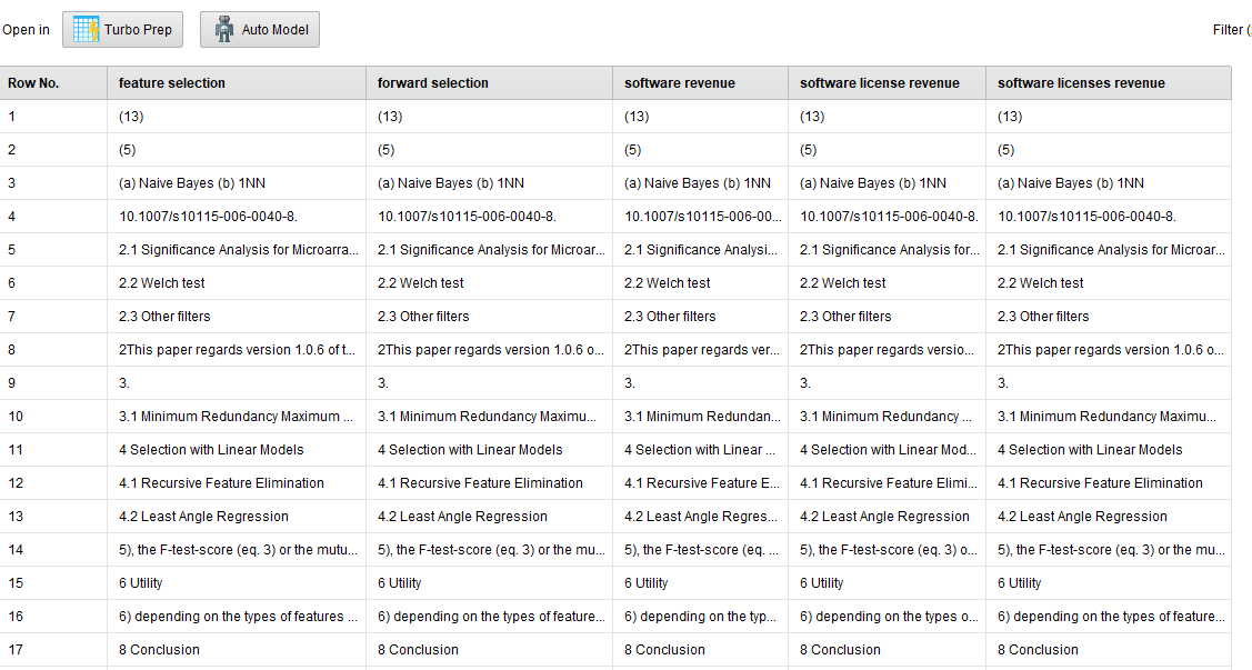

My process produces an example set with some attributes (the number of generated attributes is variable according to the set-up of the user) :
For a given attribute, I want to filter the example values based on the attribute name :
 - if the example value contains the attribute name, then the example is conserved.
 -  if the example value does not contain the attribute name, then the example is removed.

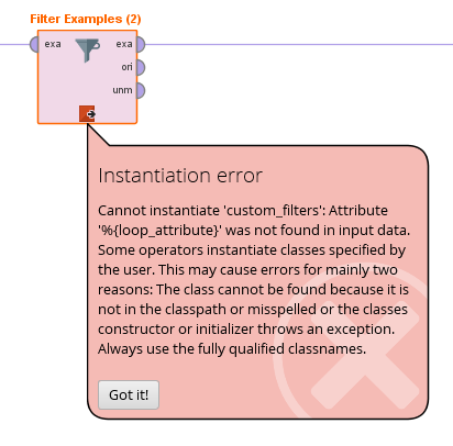

To perform this task, I try to used a Filter Examples operator inside a Loop Attributes subprocess with the following set-up :
 - condition class = expression and parameter expression
  = > this solution produces an empty example set !
 - condition class = custom_filters and   filters =
 = > this solution raises an error ("Instantiation error")

          <operator activated="true" breakpoints="after" class="filter_examples" compatibility="9.2.001" expanded="true" height="103" name="Filter Examples (2)" width="90" x="380" y="34">
            <parameter key="parameter_expression" value="contains(%{loop_attribute},#{loop_attribute})"/>
            <parameter key="condition_class" value="custom_filters"/>
            <parameter key="invert_filter" value="false"/>
            <list key="filters_list">
              <parameter key="filters_entry_key" value="%{loop_attribute}.contains.#{loop_attribute}"/>
            </list>
            <parameter key="filters_logic_and" value="false"/>
            <parameter key="filters_check_metadata" value="true"/>
          </operator>

    Below an demo process:
    <?xml version="1.0" encoding="UTF-8"?><process version="9.2.001">
      <context>
        <input/>
        <output/>
        <macros/>
      </context>
      <operator activated="true" class="process" compatibility="9.2.001" expanded="true" name="Process">
        <parameter key="logverbosity" value="init"/>
        <parameter key="random_seed" value="2001"/>
        <parameter key="send_mail" value="never"/>
        <parameter key="notification_email" value=""/>
        <parameter key="process_duration_for_mail" value="30"/>
        <parameter key="encoding" value="SYSTEM"/>
        <process expanded="true">
          <operator activated="true" class="utility:create_exampleset" compatibility="9.2.001" expanded="true" height="68" name="Create ExampleSet" width="90" x="179" y="34">
            <parameter key="generator_type" value="attribute functions"/>
            <parameter key="number_of_examples" value="6"/>
            <parameter key="use_stepsize" value="false"/>
            <list key="function_descriptions">
              <parameter key="a" value="if(id==1,&quot;a&quot;,&quot;ldjf&quot;)"/>
              <parameter key="b" value="if(id==2,&quot;b&quot;,&quot;fd&quot;)"/>
              <parameter key="c" value="if(id==3,&quot;c&quot;,&quot;j78th&quot;)"/>
            </list>
            <parameter key="add_id_attribute" value="true"/>
            <list key="numeric_series_configuration"/>
            <list key="date_series_configuration"/>
            <list key="date_series_configuration (interval)"/>
            <parameter key="date_format" value="yyyy-MM-dd HH:mm:ss"/>
            <parameter key="time_zone" value="SYSTEM"/>
            <parameter key="column_separator" value=","/>
            <parameter key="parse_all_as_nominal" value="false"/>
            <parameter key="decimal_point_character" value="."/>
            <parameter key="trim_attribute_names" value="true"/>
          </operator>
          <operator activated="true" class="concurrency:loop_attributes" compatibility="9.2.001" expanded="true" height="82" name="Loop Attributes" width="90" x="313" y="34">
            <parameter key="attribute_filter_type" value="all"/>
            <parameter key="attribute" value=""/>
            <parameter key="attributes" value=""/>
            <parameter key="use_except_expression" value="false"/>
            <parameter key="value_type" value="attribute_value"/>
            <parameter key="use_value_type_exception" value="false"/>
            <parameter key="except_value_type" value="time"/>
            <parameter key="block_type" value="attribute_block"/>
            <parameter key="use_block_type_exception" value="false"/>
            <parameter key="except_block_type" value="value_matrix_row_start"/>
            <parameter key="invert_selection" value="false"/>
            <parameter key="include_special_attributes" value="false"/>
            <parameter key="attribute_name_macro" value="loop_attribute"/>
            <parameter key="reuse_results" value="false"/>
            <parameter key="enable_parallel_execution" value="true"/>
              <operator activated="true" class="rename" compatibility="9.2.001" expanded="true" height="82" name="Rename" width="90" x="112" y="34">
                <parameter key="old_name" value="%{loop_attribute}"/>
                <parameter key="new_name" value="current_attribute"/>
                <list key="rename_additional_attributes"/>
              </operator>
              <operator activated="true" class="filter_examples" compatibility="9.2.001" expanded="true" height="103" name="Filter Examples" width="90" x="313" y="34">
                <parameter key="parameter_expression" value=""/>
                  <parameter key="filters_entry_key" value="current_attribute.contains.%{loop_attribute}"/>
                </list>
                <parameter key="filters_logic_and" value="true"/>
              </operator>
              <operator activated="true" class="rename" compatibility="9.2.001" expanded="true" height="82" name="Rename (2)" width="90" x="514" y="34">
                <parameter key="old_name" value="current_attribute"/>
                <parameter key="new_name" value="%{loop_attribute}"/>
              </operator>
              <connect from_port="input 1" to_op="Rename" to_port="example set input"/>
              <connect from_op="Rename" from_port="example set output" to_op="Filter Examples" to_port="example set input"/>
              <connect from_op="Filter Examples" from_port="example set output" to_op="Rename (2)" to_port="example set input"/>
              <connect from_op="Rename (2)" from_port="example set output" to_port="output 1"/>
              <portSpacing port="source_input 1" spacing="0"/>
              <portSpacing port="source_input 2" spacing="0"/>
              <portSpacing port="sink_output 1" spacing="0"/>
              <portSpacing port="sink_output 2" spacing="0"/>
            </process>
          </operator>
          <operator activated="true" class="append" compatibility="9.2.001" expanded="true" height="82" name="Append" width="90" x="447" y="34">
            <parameter key="datamanagement" value="double_array"/>
            <parameter key="data_management" value="auto"/>
            <parameter key="merge_type" value="all"/>
          </operator>
          <connect from_op="Create ExampleSet" from_port="output" to_op="Loop Attributes" to_port="input 1"/>
          <connect from_op="Loop Attributes" from_port="output 1" to_op="Append" to_port="example set 1"/>
          <connect from_op="Append" from_port="merged set" to_port="result 1"/>
          <portSpacing port="sink_result 1" spacing="0"/>
          <portSpacing port="sink_result 2" spacing="0"/>
        </process>
      </operator>
    </process>
