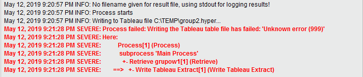

0. I work with RM Studio 9.2.001 and Tableau Desktop 2019.1.3 on WIN7 64
1. I have downloaded Extract API from
tableau2. I have also downloaded Tableau Table Witer from
RM (it shows 8.2.1 compatibility)
3. I followed the steps described in
RMdocsnamely:
3.1. extracted zip file to C:\Users\ML\.Tableau\Tableau Data Extract API
3.2. added C:\Users\ML\.Tableau\Tableau Data Extract API\bin
3.3. created entries TAB_SDK_TMPDIR and TAB_SDK_LOGDIR in both User variables and System variables with the same locations: C:\Users\ML\Documents
3.4. installed Tableau Table Writer rapidminer:///extension/rmx_tableau_table_writer

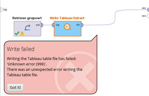

4. I have created a simple process which failed as described below.
Any suggestions?
