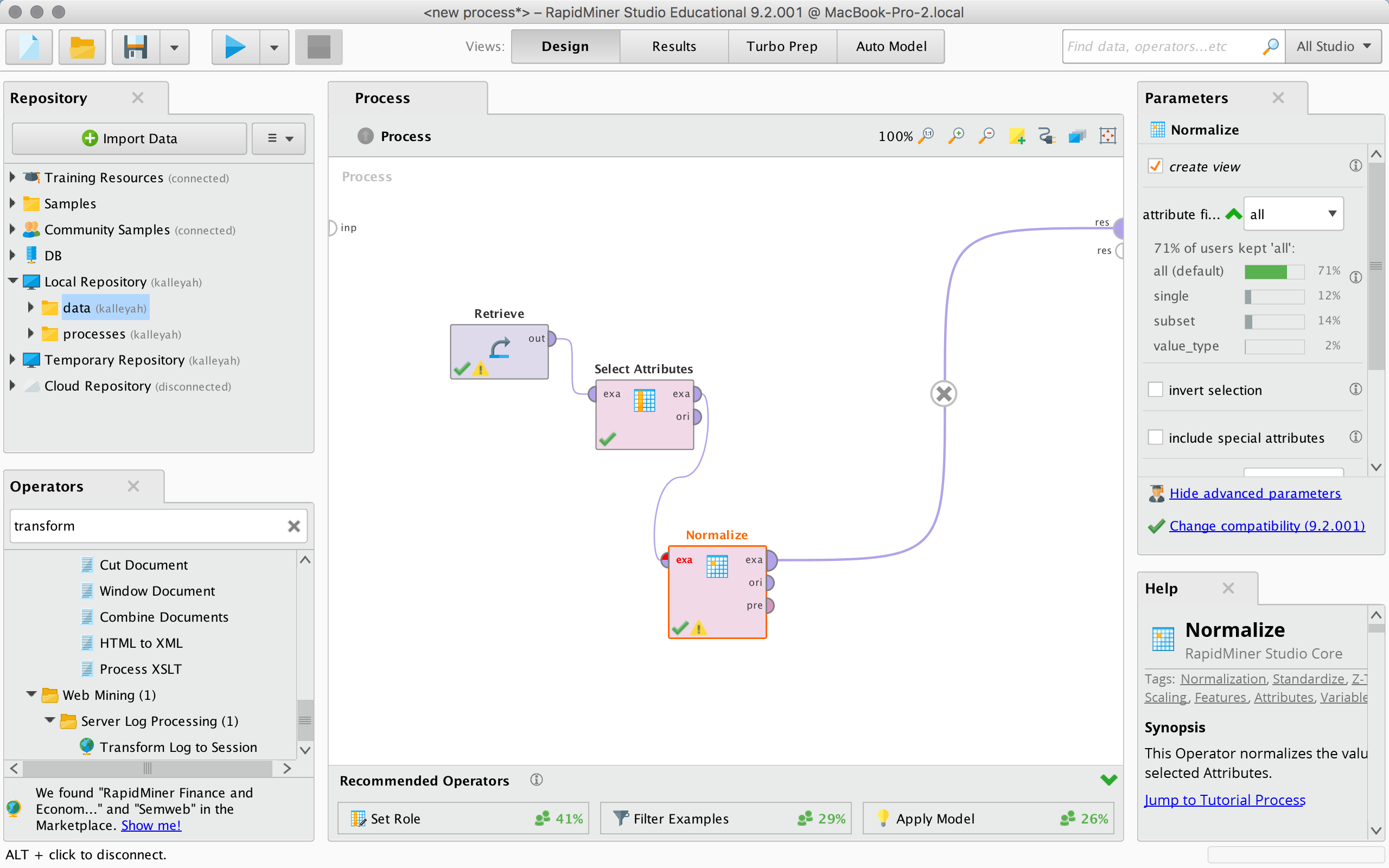

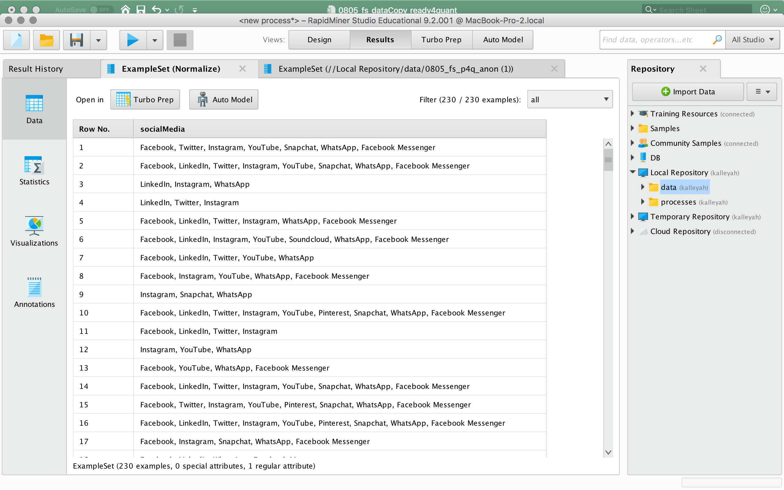

I have a list variable (social media usage) that I would like to recode in a few easy steps from list to a collection of dummies (sm1, sm2, sm3, ...).
My process looks like this:
And my output looks like this:
I'm an intuitive learner and just started with RapidMiner 2 days ago, I understand that at this point I'd need to introduce a transformation/ recode variable operator in between normalisation and results, but I'm not quite sure how to do that. Didn't find any transformation/ recode operator in the operator pannel.

Hi,You can use the operator "Split" for this with the setting "unordered split". Below is the XML code of a process with a small example.Hope this helps,

Thank you, it worked wonders. The split operator was what I was looking for, I just didn't know it was called that way.0
