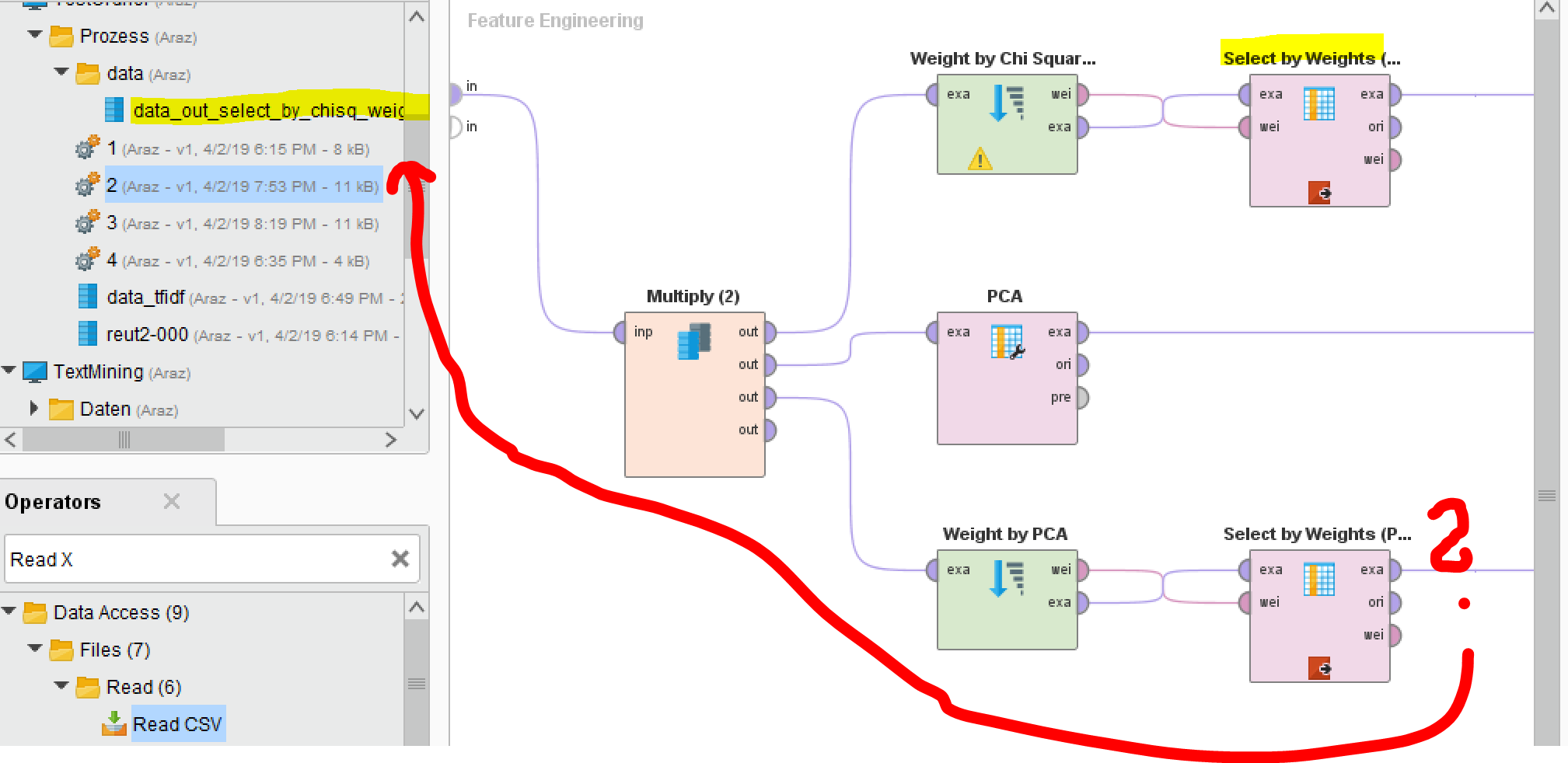

Hello,
I have configured the process here with the calculation via TF IDF. If I start the process, would the process actually give me the output as the Data_out_selected_by_pca or?
I visualized the whole thing again briefly (see screen)
BR,
Flixport
(Screen)

    No, you will not have nominal attributes after vectorization.
     Can you take a look at the process above? My feature engineering subprocess works fine for PCA

    No, I did not insert anything via drag & drop. Is that necessary? I ask because I did not insert anything at Chi Square. Of course, my input data is already ready as a CSV file, the attribute values ​​are also numeric, so I can not understand that unfortunately
    BR

    the input is also correctly connected
    2.JPG 335K

    For sure @varunm1
    i have inserted the folder for you to understand the relationships + the input csv data
    I would be very happy to reveice a helpful answer
    BR
  • YYH
    YYH
    Altair Employee
    Hi @Flixport,
    I suggest you add an operator for text vectorization. Otherwise the text data is not vectorized into TF-IDF vectors.
    I used the Reuters data reut2-000, and added vectorization before feature selections. After text vecterization, we have almost 1000 attributes for the keywords, with weight by PCA and feature selection, we kept 50 attributes.
    I have sample process for text classification using 20k+ Reuters news, PM me if you need.
    Here is the process fixed for feature selection. Enjoy!

  • Flixport
    Flixport New Altair Community Member
    The problem with this thing is that PCA can only work with integer and my input consists only of polynominal values. For the reduction of dimensionality I would like to use both methods. Is there perhaps a way out? Thank you
  • YYH
    YYH
    Altair Employee
    Answer ✓

  • Flixport
    Hey all,
    my process is ready. I can now extract the most important words of the Reuters News via an X of any ID. (See screen)
    Does anyone want to look at my process, PN me.
    I am looking forward to improvement potential.
    BR
    (U can see here the most important words of a Message. Can I also add the title and date in the charts, is there a possibility?
