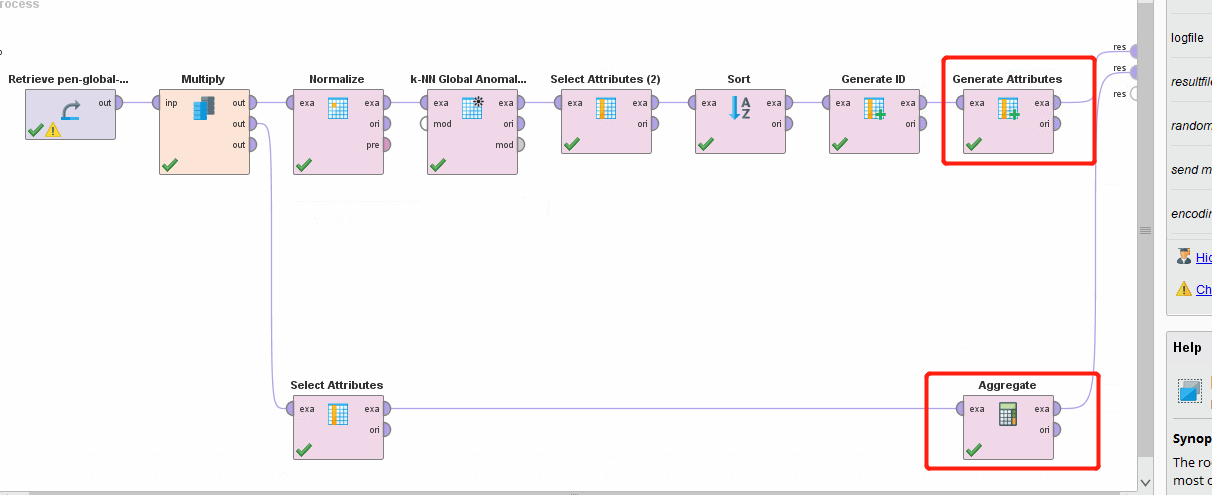

How to get a value from the output of a operator in RapidMiner?
I want to get a value from the output of a operator in RapidMiner, and input the value into the parameter of expression of another operator.
My process XML is attached below.
The picture corresponding to the XML is as following,
The output of the Aggregate operator is as following,

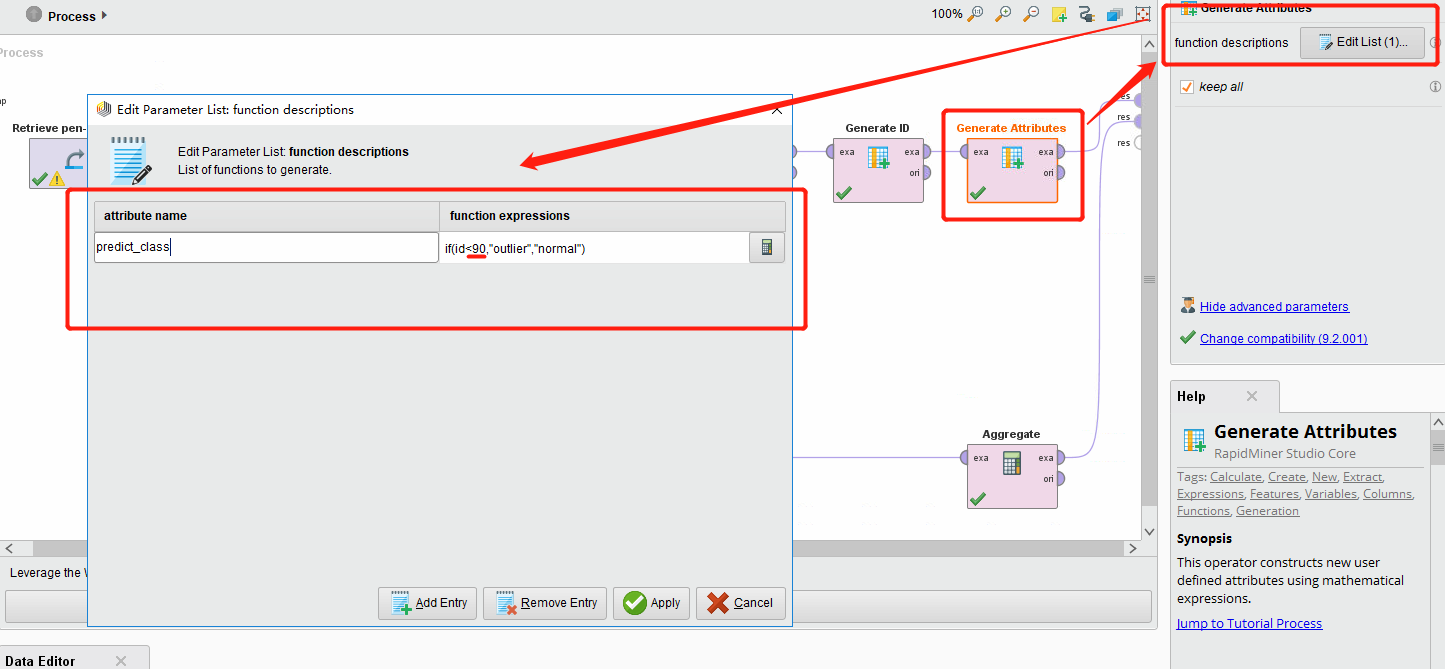

The paramenter needed in Generate Attributes operator is as following,
The parameters "90" needing to be set in the Generate Attributes operator correspond to the "90" in the above picture.
I want to know whether the "90" induced by the Aggregate operator can be passed to Generator Attribute operator. Now I set the parameter "90" manually. I hope that this process does not require manual intervention.

After your aggregate add an additional filter operator, and filter on 'class=outlier', you can keep the rest of the process as is, just use the original output of the filter operator to continue your current process.
On the filter output you now add an extract macro operator, select data value as type and set example index to 1. Under attribute name you set 'class' and name the macro like outlier. This basically stores the value of the filtered class (in this case your outlier) and keeps it in memory.
Now you can change your expression to if(id<%{outlier},"outlier","normal") and the value will automatically change without further human impact needed.
Note that it is important that your macro process runs before your expression is called.
