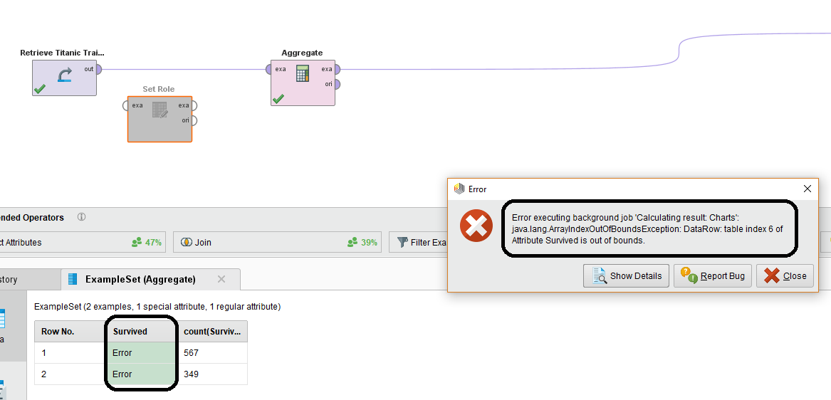

I think I found a "fun" bug in the Aggregate operator by playing with the now famous Titanic dataset :
I wanted to calculate the count of the label "Survived" (Yes / No) :
So I set the following parameters :
- Aggregation attribute : Survived
- Aggregation functions : count
- Group by attributes : Survived
When executed, the process raises the following error :

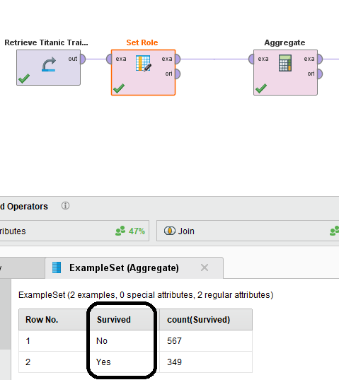

When the label "Survived" is set as regular (using the Set Role operator), the process works fine :

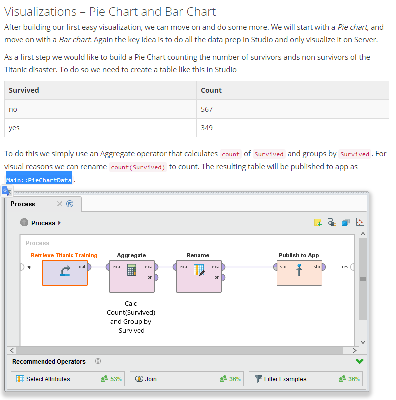

It is possible that this bug has been reintroduced because a priori the process was used (without error) in the documentation
about "Create Web Apps" :

Hi @lionelderkrikor,
this bug occurs when you aggregate on a special attribute. I think I've already reported it. Can you test if it's present in 9.0 BETA?
