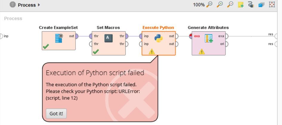

  • vittorio_confuo
    vittorio_confuo New Altair Community Member
    Hi @lionelderkrikor ,
    I solved this problem but I currently have another one.
    The process return me the following error:
    Do you know how I can solve it?
    You are very kind
    Regards,
    Vittorio Confuorto
  • lionelderkrikor
    lionelderkrikor New Altair Community Member
    Hi @vittorio_confuo,
    Can you share your dataset and your process, so that I can reproduce the bug.
    Regards,
    Lionel

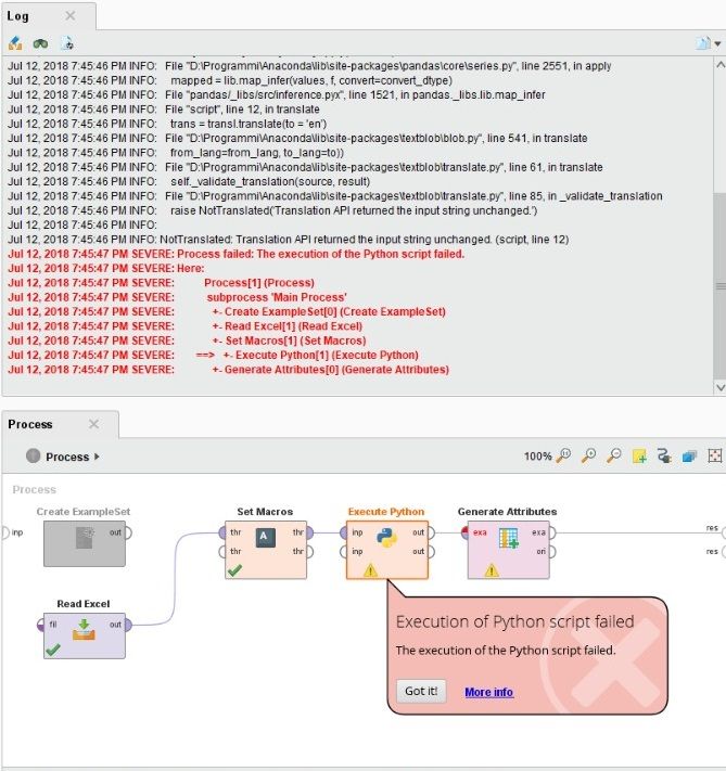

  • jozeftomas_2020
    jozeftomas_2020 New Altair Community Member
    Hello.
    Mr. @ lionelderkrikor
    I run your code but it has an error.
    what's wrong?
    Thanks a lot

  • lionelderkrikor
    Hi @jozeftomas_2020,
    Here the process works fine :
    Some questions :
     - Have you sucessfully install TextBlob ?
     - Do you execute Python 2.x or Python 3.x
     - Have you modified the dataset in the parameters of the Create ExampleSet operator ?
    Can you send me back your process in order I try to reproduce your bug ?
    Regards,
    Lionel
  • jozeftomas_2020
    Hello
    My process is exactly your code
    Yes I have python and textbolb installed.
    But I do not know why it does not run.:smileymad:
    Could you check this data? Sorry sorry
    https://community.rapidminer.com/t5/RapidMiner-Studio-Forum/How-to-correct-the-wrong-words/td-p/51027/page/3
    This is the same Twitter data
    thank you very much:heart:
    Have a great day
  • lionelderkrikor
    OK, I think I understand :
    The process in this thread is able to study the sentiment of a text which is not in English.
    Your entry dataset is already in english, so the Python script raises an error when it try to translate it in English.
    If you want study sentiment of english text (in your case tweets in english), use this process :
