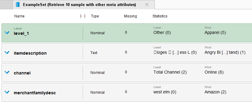

    Hi Adam @adamf,
    Please refer to the process here for predicting the category of onsale items with text mining.
    My input data has text descriptions of the purchased items (attached is an example input), and also some meta-attributes for the channel, merchant names. Of course you can create a customized wordlist and ust it as the input for text processing (word list input).
    Regards,
