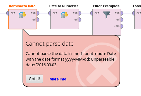

have a process which uses a time series data input from csv it works with the date as 2016-02-24 but not with the date as 2016.02.26 obviusly I need to set Nominal To Date operator to a date format with the new format without dashes. Cannot see the option to do this or am I missing something?image.png

    under the Parameter settings for the Nominal to Date Operator you can specify the exact date format of you input. There are already some predifined formats in the drop down menu, but in your case  the format string should be the following
    • yyyy.MM.dd
    yyyy stands for a 4-digit year, MM is a two digit month format (compared to mm which is minutes) and dd are the days.
