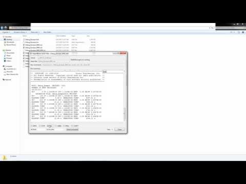

Hi. I watched the videos on this link
https://www.youtube.com/watch?v=VWCcwranpqY&index=4&list=PLQ7KUGFuVz4uyfru1mekcmyqb783jA862
But when I press F10 it said that 'there are no vail elements on the screen'. Could any one explain me the reason
and how to choice the 'failure criteria'
Thank you

I was able to reproduce this error. And I think this option is not compatible with this material card.
Meanwhile, please run the model file in RADIOSS and you can check the time step of the elements in the starter out (_0000.out) file.
