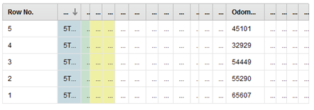

Here is a portion of the ExampleSet in RapidMiner that is being fed into the Write Access operator. These are the correct values.

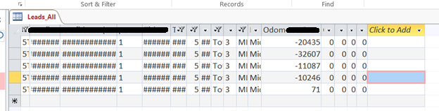

Here is how it is being written into an Access table:
Can someone explain to me why this might be occurring? And how come it's only occurring on a portion of the example set?
