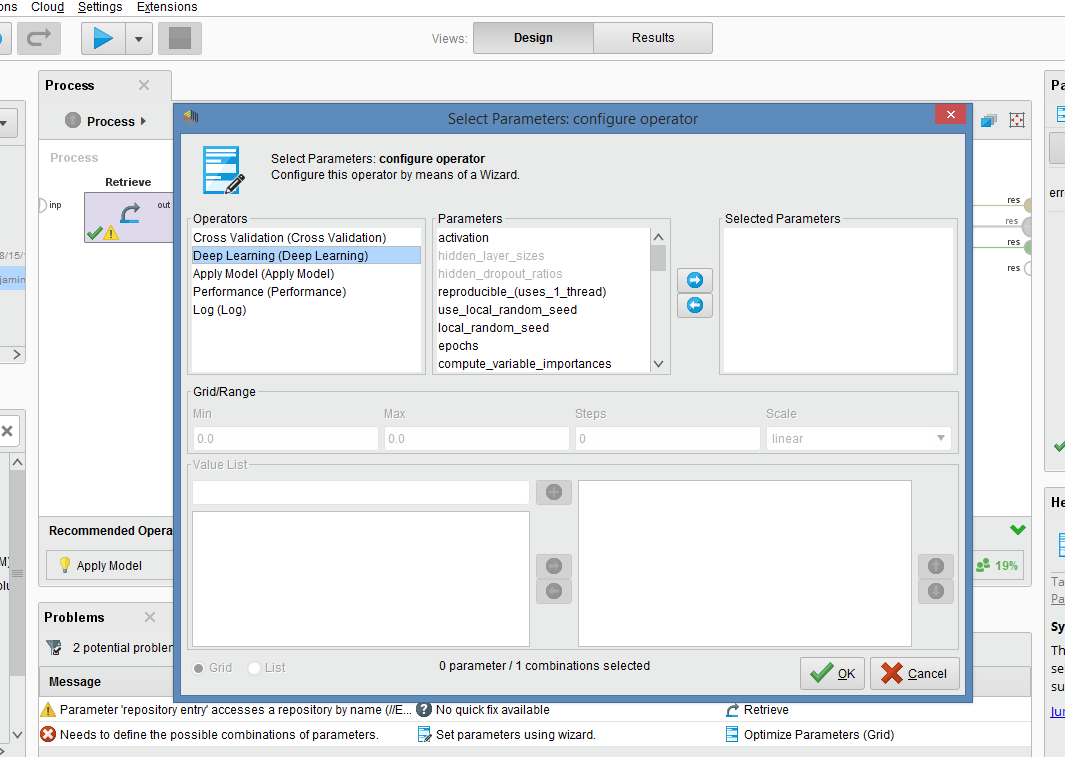

    Hi Thomas,
    Yes. I attached the process and a screenshot here. In the screenshot, you can see the "hidden_layer_sizes" parameter is disabled when I choose the "Deep Learning" operator for optimization. So how can i enable it?
  • Thomas_Ott
    Thomas_Ott New Altair Community Member
    Huh, that's interesting.  Try using Set Macros to inside the hidden layers and vary those values.

  • cyborghijacker
    cyborghijacker New Altair Community Member
    Hi Thomas
    I have encountered the same issue, where the network hyperparameters are greyed out in the grid search UI. May I know how do I implement the method you have mentioned? Where do I place the Set Macros?
    Thank you
    Regards
    Corse
  • Thomas_Ott
    Ah I think you have to toggle on 'List.'
  • cyborghijacker
    How would I do that? The options are greyed out actually (i.e. Grid/List)
  • FBT
    FBT New Altair Community Member
    You need to select the parameters you would like to optimize first (the middle column on top). Once you have done that the selection between "Grid" and "List" becomes available.
  • cyborghijacker
    Yes it works with the other parameters, but in this case the Parameters of hidden_layer_sizes and hidden_dropout_ratios are greyed out, clicking on them yields no further selection options.
    Has anyone else encountered this issue? Apart from this, doing a manual search is possible, but it will be a hair thinning exercise. I shuddered at that thought.
  • FBT
    Ok. Apologies, I did not read the full thread up until now. It is indeed a bit unusual that this is greyed out. Have you taken a look at the process that @Thomas_Ott posted above? In it, he set macros for the layer sizes within the "Optimize Parameters" operator, which are then used in the hidden layers panel of the "Deep Learning" operator, instead of using actual numerical values --> see screenshot.
    If you do that, you should be able to select those said "Set Macros" operators within the optimization panel and enter the values that you would like to iterate through.
  • cyborghijacker
    No problem, and thank you for the clarification.
    In fact, in Thomas' earlier video (https://www.youtube.com/watch?v=R5vPrTLMzng&list=PLLdyjsPklEJvpxLHZM-llt40FLw-qEiZO&index=1), around the 8:40 min mark, we also see that hidden_layers for Neural network is greyed out, although it was not highlighted.
    I am still unsure how to use the Set Macros using the script Thomas posted. Where should it be placed? Nested within the Optimize Parameters operater before Cross Validation?
    Regards
    Ben
  • FBT
    You can just copy the XML of Thomas' process and paste it into your XML panel in RapidMiner. Then press the green checkmark and the process will appear in the process panel.
  • cyborghijacker
    Hi FBT
    I see. In essence, its just creating the no. of Set Macro operators to be the no. of hidden layers? I'm assuming the Set Macros can be used instead of defining one Set Macro for one hidden layer. For the optimizing, I will still have to change the macro value ( = no. of nodes) manually correct?
    Regards
    Ben
  • FBT
    Hi,
    not really. The whole point about using "Set Macro" operators is to make the parameters available within the "Optimize" operator in which you can set the values you would like to iterate through. Take a look at the screenshot:
    I have renamed the two "Set Macro" operators from Thomas' process to make it a bit clearer in the optimization pane. You can now either use the grid selection by setting a range of values and the distance between values for the layer, or you directly define your desired values with a list (you would just need to check the "List" radio button).
    Using the "Set Macros" operator with which several macros can be defined at once, brings you back to the problem of the selection being "greyed out" in the optimization pane. Hence you would need to use one "Set Macro" operator for every hidden layer you want to iterate through.
  • cyborghijacker
    Hi FBT
    I see, I can get a clearer picture now, your first statement was key. Now I face another strange Problem Message. I defined 3 layers as per Set Macros connected to Cross-Validation with a Deep Learning operator within it.
    Any chance this error could be diagnosed? Has it got to do with strings vs. integers in Rapidminer?
  • FBT
    Ok, you are right. Values set in the "Set Macro" operator are strings. This is usually not a problem in other contexts, as you can use eval() or parse() to convert it to a number. In your context, however, this does not work and we need to get a bit more creative. What seems to work is the following:

    This process is very similar to the one before, however, instead of using "Set Macro" operators, you start by reading in an Excel or CSV File that consists of one column --> "LayerSize". In this column you have the hidden layer sizes you want to iterate through. It is important that you read the values in as numerical types, otherwise you will run into the same issue as before. If in doubt, use the import wizard.
    Now, instead of setting the macro values directly, you can extract them from the read-in file, which contains your layer sizes, with the "Extract Macro" operator. By setting the macro type to "data value" you get a new parameter called "example index". This is basically just the row number in your Excel sheet and luckily you can iterate through it within the Optimize operator.
    My Excel sheet had six values for hidden layers, hence I am iterating through from 1 to 6. You will need to adapt accordingly, depending on how many values for hidden layers you have. You need to use one "Extract Macro" operator for each hidden layer you would like to iterate through. If the values you would like to iterate through for different hidden layers are not identical, you would need to create more than one Excel/CSV file and read them in, as shown in the process above.
  • cyborghijacker
    Hi FBT
    Oh I see, I was trying to put eval() into the hidden layer size in the Deep Learning operator. So it was an issue with 'strings' being read by the Set Macro operator. I have implemented the workaround that you have suggested, and it works well, although sometimes the Deep Learning shows a Warning message about the macro not being defined.
    On a separate note, do you know what the 'standardize' parameter in DL does? It says:
    standardize (optional)
    If enabled, automatically standardize the data. If disabled, the user must provide properly scaled input data.
    Once again, thank you for your detailed clarifications on this topic.
    Regards
  • FBT
    I believe that this parameter rescales your attributes to have a mean of 0 and and a standard deviation of 1. Also, it assumes that your data has a Gaussian distribution.
  • cyborghijacker
    I see, so its essentially an in-built Normalize operator with the Z-scaling method. I'm assuming the user can choose between a manual normalization or simply checking this parameter?
  • CkNN_Algo
    CkNN_Algo New Altair Community Member
    You can put READ EXCEL outside of the optimization block. Doing so prevents the file from being read over and over: helps your drive and execution speed.
