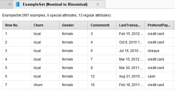

However the attribute IS present, as shown by putting a breakpoint after Nom to Bin:

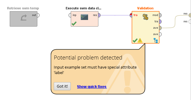

Furthermore if I Execute the ETL process as the first steps in the training process, I get an error that label information is missing (but surprisingly I am able to train the model anyway):

a general thing is, that the difference between nominal and binominal is rather a meta-data thing than a real problem. The meta data tells the SVM that this is nominal. Once the data "arrives" RM can check and realize, that the data is nominal, but only has two classes. So it can run. This is why the SVM produces no error.
