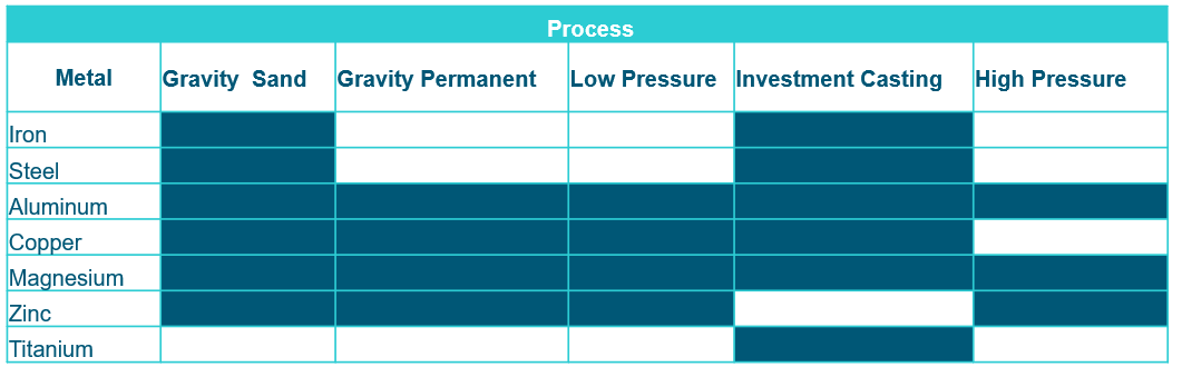

I have a question about when I created new material. In Inspire Cast what material parameters are most important for cast part and mold (I have to enter all material parameters)? Besides, when I use advanced meshing with SimLab tool, What is the basis for choosing the optimal mesh size? Can I run low-pressure die casting for steel material? Because I see that they recommend using other materials.
