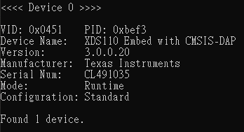

Can you try interacting with the board using uniflash and check if the board is working correctly??
https://www.ti.com/tool/UNIFLASH .
Also try updating the emulator onboard . Follow the steps as mentioned in the link below
https://e2e.ti.com/support/microcontrollers/c2000-microcontrollers-group/c2000/f/c2000-microcontrollers-forum/753823/faq-ccs-launchxl-f280049c-advisement-emupack-8-0-903-4-incompatible-with-launchxl-f280049c

It works after updating the emulator onboard.
