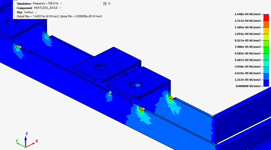

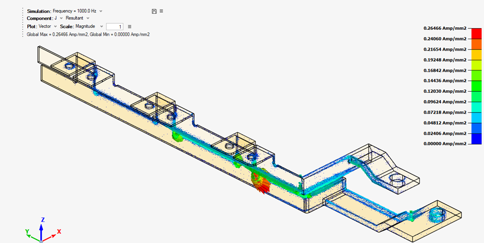

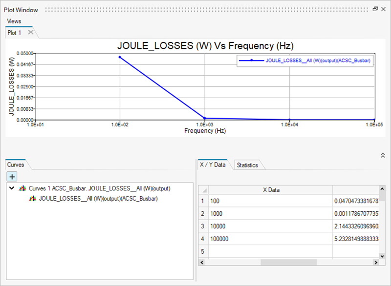

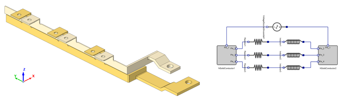

The tutorial present how to use the SimLab-EM solution to model an electric vehicle busbar and run a basic electromagnetic analysis. by a AC supplier conductors solutions (by a new integral method-based EM solver).
Analysis
The electromagnetic analysis is performed in the frequency domain, by using the SimLab AC supplied conductor solution.
Results
