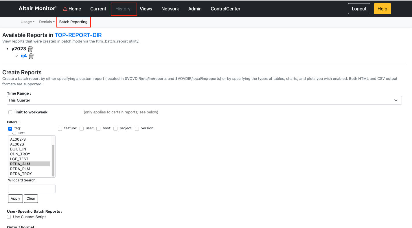

When in doubt, run a batch report with Web UI and select HTML report format which will include the exact command line options.
  • Go to History > Batch Reporting tab.
  • Select the time range, tag (/features), report type.
Be sure to select “HTML” output format.
A screenshot of a computerDescription automatically generated
  • Once the report is generated, you should see the exact command “ftlm_batch_report” with all options listed at the top of the report.
