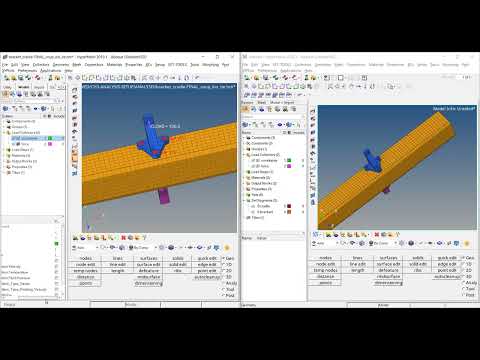

Please review the video below for having a first glance at the main changes introduced between 2019 and 2022:
https://www.youtube.com/watch?v=_F5owJKw5r4
