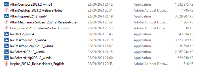

These are the installer files I have available. Which one should I use for the new installation?
Hello Matthieu, I followed your procedure and installed again using hw2021.2_win64.exe. In the packages selection the Solvers 20201.2 box was selected but I couldn't see Radioss or Optistruct explicitly. Now the installation is done and I have the Compute Console 2021.2 item in my start menu under Altair 2021.2. Still there is no Radioss application on my pc as it was with the 2017 version. Is it correct? Perhaps there is a new structure and integration of the different tools through the Compute Console with the newer version?
OptiStruct and Radioss are part of the Solvers package. You can start them using the Compute Console or from our GUIs such as HyperWorks or SimLab.
