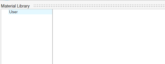

Why is material library and Environment section empty in Inspire Studio?

I have the same problem with Inspire Studio 2021.
Deleting the .altair folder did not help.
Do you have another advice?
Thanks a lot.
Same here with Render 2021.2.1
