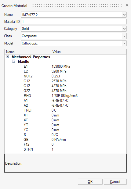

I can't seem to fix this issue, the messages I get are:
*** See next message about line 17 from file: Solution.fem
" TEMP = 1"
NOTE # 2045
TEMPERATURE(MATERIAL/BOTH) should preferably be defined above the subcase
level. If used inside subcase, then the last occurrence will define
the material temperature.
*** See next message about line 36 from file: Solution.fem
(this is continuation line 1 of MAT5,1 bulk data)
"+ 0.0 0.0"
This line was interpreted as:
36:+ , 0.0, 0.0
*** ERROR # 1000 *** in the input data:
Incorrect data in field # 2.
Expected REAL > 0 or blank, found REAL (0).
*** WARNING # 1200
Incorrect or inconsistent data found in $HMxx cards.
(Obsolete data format or problems because of manual editing.).
All HyperMesh specific data will be skipped from input files.
Component information in the output file will be missing.
To rebuild this information - read back and recreate input file
using HyperMesh. This happened in line 90212 of file
"Solution.fem":
*** PROGRAM STOPPED: FATAL ERROR(s) ENCOUNTERED.
