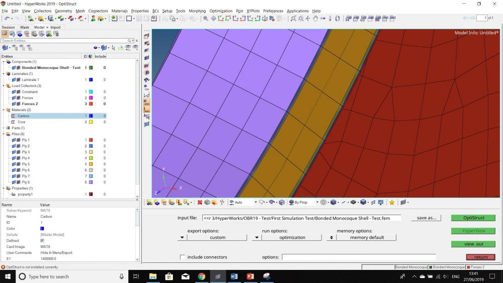

Dear Madam/Sir,
I recently downloaded HyperWorks Desktop 2019 from connect.altair.com/downloads.
The software is working, but when I am trying to run an analysis, I get an error message: 'OptiStruct is not installed currently' (find attached). In Altair Connect downloads list, I couldn't find any OptiStruct installation.

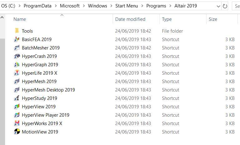

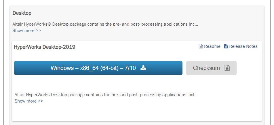

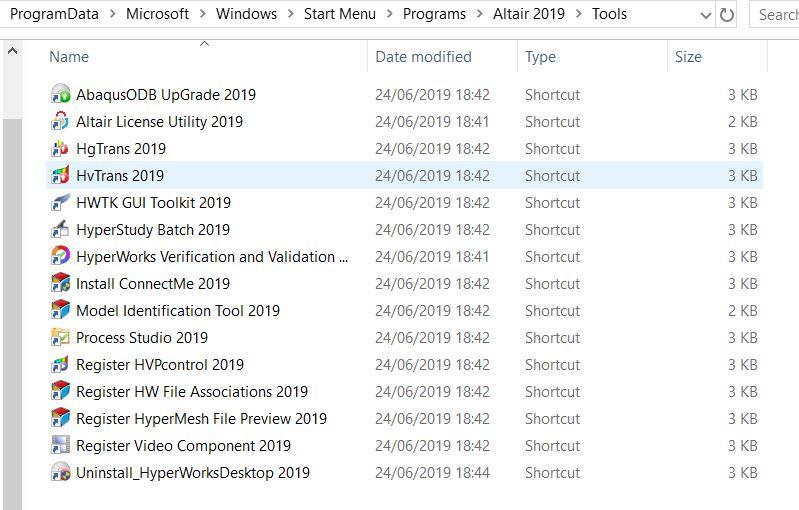

    I downloaded the HyperWorks Desktop 2019 (find attached) and the License Manager. I already deleted the files that I downloaded.
    I also added pictures with all the software and tools that were installed. Seems like OptiStruct wasn't installed.

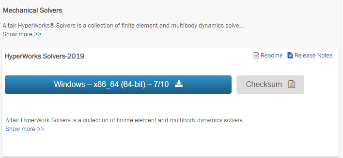

    Hi Doron
    You have to install HyperWorks solvers separately. It is available in Altair connect

    Dear Mr. Hari,
    Thank you for your reply. The problem is now solved.
