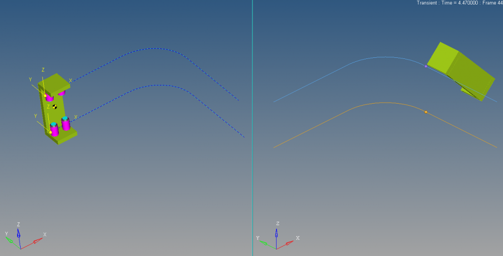

I'm trying to simulate a shuttle moving along a guide, which is simplified with two curves (Up and DOWN). As you can see here below and in the attached files, I simulate the four wheels with four bodies joined to the shuttle through 4 bushing elements with high rotational and translation stiffness. Each wheel is constrained to the relative curve through a Point To Curve constraint.
In order to move the shuttle, I have firstly applied a constant force along the x axis of the shuttle and everything works well.
Since I got to simulate the behavior of an electric motor, I would like to apply a motion law. Therefore I created a simply motion with constant speed set to 100mm/s. When the shuttle compete the guide's curve (so it changes the axis of motion from x to y), it 'blows up', releasing itself from bushing elements. I tried to define the motion between other markers, but I don't get the desired motion.
