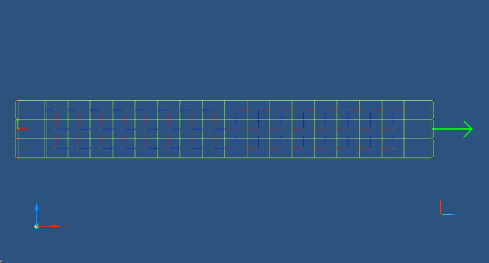

i like to simulate a tensile test of an UD FRP in HyperCrash.

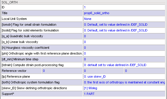

Therefore i use BRICK elements, the material LAW25 and the propterty TYPE6.

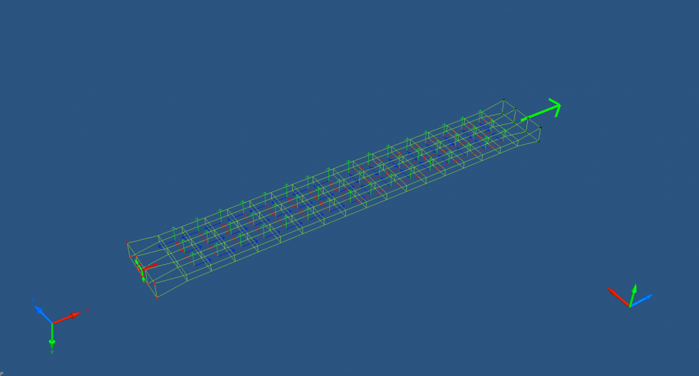

To model the 90° fiber direction (perpendicular to the velocity boundary condition) i made a skew (to see in the bottom right corner of the pictures 2 and 3) and used it in the property type 6 to define the orthotropic direction (to see in picture 1).
Now the RST vectors (what are these?) dont have the right and uniform orientation (to see in the pictures 2 and 3)
How do i define a 90° fiber direction?
