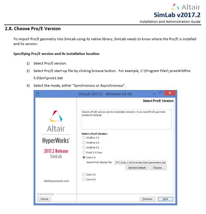

I read in the GUI that you should set the new quotes, when you modify the model in Creo (point 3), as design parameters, so that when you re-import it in SimLab you have to check that 'Design Parameters' import option is on and model should update automatically, but I couldn't try this way cause I have another problem:
B ) Everytime I choose the option 'Import CAD' and I select a .prt or .asm file then Windows says that there is a problem in finding the installation directory (I am not the first person in my company who encounters the same problem, so probably is not due to installation errors). So the only option I have is to use 'Import->CAD through traslation' that opens a step (.stp) file auto generated by SimLab, but all of that makes parameters being lost.
Did somebody else encountered the same problem?
