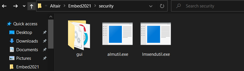

3. I am sorry but I couldn't find 'licensing.log' in the mentioned folder. I installed Embed in my D drive and these are the files available in the 'security' folder.

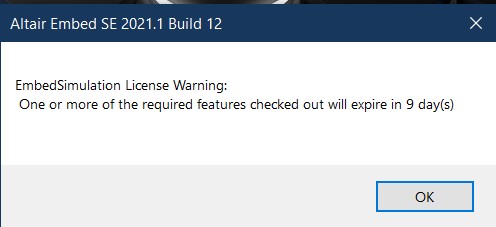

One last thing I would like to ask about is that upon opening Embed software, I get the following message.
I hadn't noticed the name initially, however after reading your reply, I am sure that Embed SE got installed from the student license.

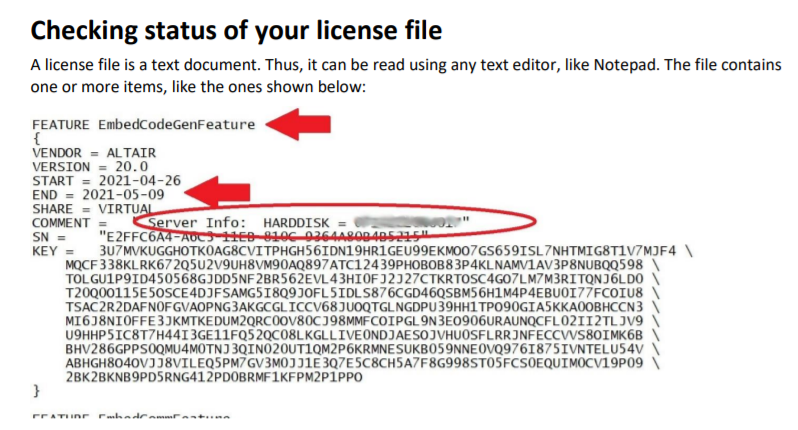

What does it mean to 'upgrade my license'? Does it mean that I need to purchase a professional license so that I can use the codegen feature. I think that the student license doesn't provide Embed software for free. The reason why I think so is that I opened the 'altair_lic.dat' in notepad and these are the only available FEATURES:
I checked in the Embed Installation Guide and in Pg 18, they show that the license file should contain features like:
My license file doesn't contain features like EmbedCodeGenFeature, EmbedSimulationFeature etc.

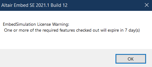

Due to this, I am getting the following message:
So, how to proceed from here?
