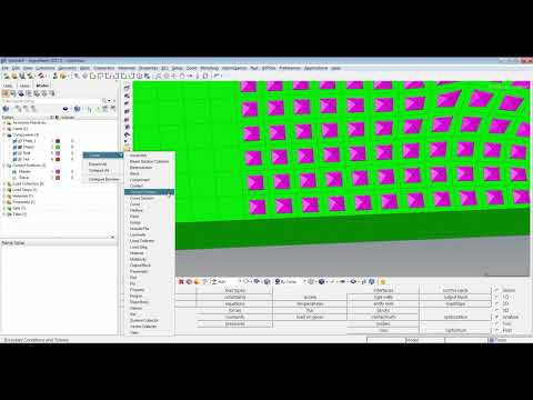

    Because contacts are automatically created with a surface set, if you enable this option in the preferences:
    your contact set will update.
