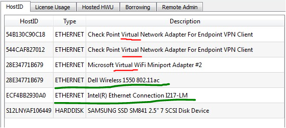

This is the 3rd time I receive the license for WinProp software student edition and having the same mistake "my computer physical address does not match the one that mentioned in the license". Attached image illustrate the problem
Are you still having issues with activating the license?
It is possible that you are providing the virtual netowrk adapter codes to generate the license which have the potential to change. In general, it is recommended to use the physical adapter codes for license generation.
If you have 'AlmUtil' installed (which will be installed along with Feko/WinProp), you can look at the host IDs and give the physical adapter codes for license generation:
