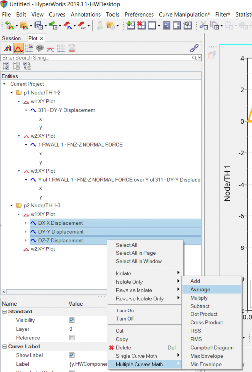

If MVP toolbar is the solution, it is available for Student edition?
Any work-arounds?
Thanks
Need to find about MVP support for Student editions, but can you check if this is available from standard PlotBrowser ?
