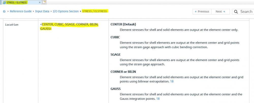

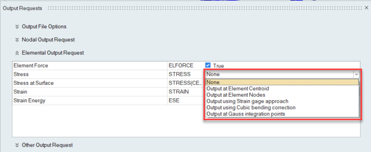

Hello,
Someone know the difference between this methods? Depends which one is used the results vary a loot. (SimLab2019.3)
Thanks
As per OptiStruct Stress output section.
<?xml version="1.0" encoding="UTF-8"?>
Okei perfect, thank you.
