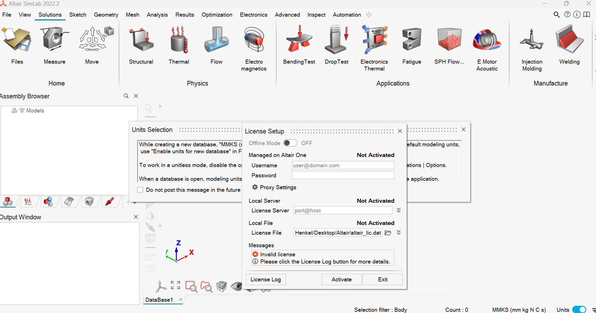

Good morning,
I recently purchased a license.
After downloading Simlab from the marketplace and installing it locally within a dedicated folder, I saved the license file within the same folder. I have indicated the location of the license but it keeps giving me problems by saying the message "Invalid license" providing these additional details:
[04/26/23 11:37:33] Trying activate features...
[04/26/23 11:37:33] Trying to activate...
[04/26/23 11:37:33] Deactivating features...
[04/26/23 11:37:33] Activating...

Could you please help me?
Thank you,
Simone
