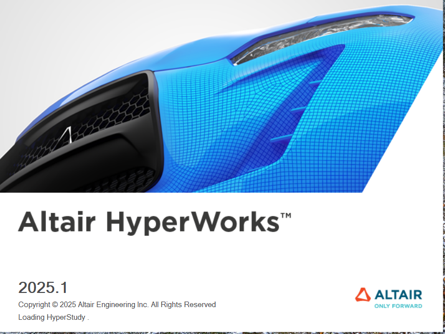

Hi I am having a problem with HyperStudy. It won't open.
After displaying this screen, it does nothing else. Please, can anyone give me some advice?
