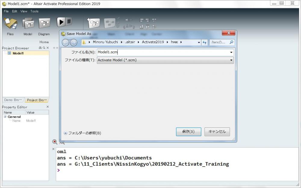

I changed the default working directory as your advices, then created a new model and tried to saved it, but the model was not saved in the directory (see the picture attached). Please let me know what I did wrong.

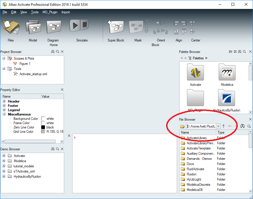

Working directory and load/save directory are two different things. In working directory e. g. oml-scpripts are searched for. In the GUI you set the directory in the File Browser
The load/save directory is always the last directory you have used for opeing or saveing a project. The setting can be found in c:\users\<username>\.altair\Activate<version>\hwx\settings.xml in section Session
<section name='@Session'> <section name='DirectoryBrowser'> <entry name='Open Directory' value='D:/home/ActivateLibrary/_demos/Circuit models/' type='string'/> <section name='History'> <entry name='@name' value='D:/Hub/Christian' type='string' current='1'/> ...
If you can set your preferred directory automatically e. g. in the startup script, I don't know.
