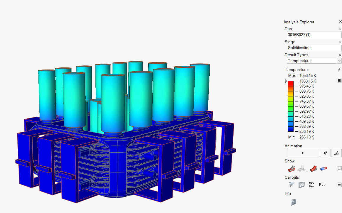

Marked Ingates not working.
Could not find the reason.
Please advise.
Link to the file: https://we.tl/t-Jh8kArE5l2
Uri, Try running with Virtual Mold analysis.

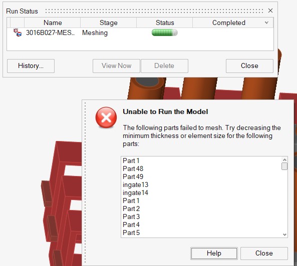

Hello
With virtual mold mesh fails
Link
https://we.tl/t-FQHuqrCLxm

1. Please check if you get good fill, as at my session
2. Also, could you please send me the file that you run with virtual mold?
3. What mesh size did you use
